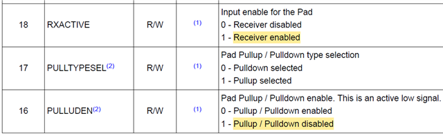

  • Hi Paul,
    After boot from eMMC on SK-AM62, the padconfig value are 0x50000, which shows eMMC pin pulls are disabled and receiver enabled. it violated the statement from schematic check list:
    "The eMMC device will turn off its MMC0_DAT1..3 pulls when entering 4-bit mode and MMC0_DAT1..7 pulls when entering 8-bit mode. The eMMC host software should turn on the respective DAT pulls when it changes the mode."

  • If so, this is a software bug that could impact long-term reliability of the AM62x and eMMC devices by allowing the signals to float when not driven.
    You should file a bug to highlight this issue.

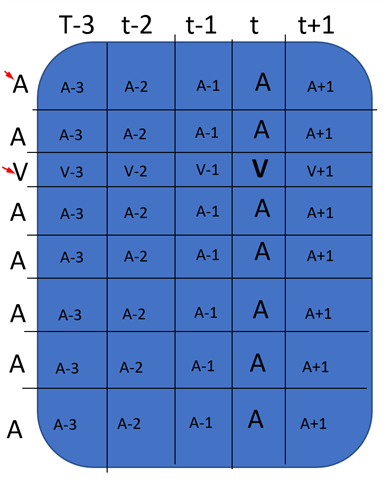

  • Hi Shriram,
    I understand there are two type interference described in the slides:
    #1. SSO: supply switch noise of worst case when switch simultaneously.
    #2. ISI: caused by reflections by impedance mismatch.
    For this customer's case, replace serial resistor from 0ohm to 22ohm/33ohm eliminated eMMC IO/CRC/CQE error on boards which can reproduce definitely when with 0ohm resistor.
    By probing signal, there is not obviously change to signal quality with either resistor value.
    How do you think if it related to SSO or ISI?
    BTW: What is A and V stands for here? in the table
  • Tony, The A in the table stands for aggressor while V stands for victim. I am not clear about the statement regarding how replacing the resistor value impacted the error observed. Regarding SSO vs ISI, it is pattern specific. Worst case SSO will be excited by simultaneous switching of all signals. Worst case ISI will be excited by switching a data bit from a long stream of 0s to a 1 and then back to 0 in the next cycle. So a long stream of 0s followed by 0101 type switching. Vice versa for the opposite logic state as well.
    I am not sure if it is talking about the pull ups inside eMMC for software to control, and not sure if it is really enabled. not sure who can comment it.
