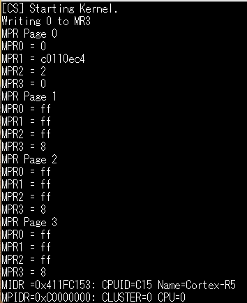

  • I rewrote the GEL script into C code and ran it, but it didn't work.
    It seems that writing to MR3 failed because the address is incorrect.
    Please correct the code.

  • Takeshi,
    Did you initialize the memory first?  Your code looks correct, i don't see any issues with it.  Did the code get stuck in one of the loops?  Can you ensure the CTL registers are getting written correctly?
    James
  • DDR_init was not executed during the initialization process, so I corrected the code.
    However, even after making this correction, it still does not work properly.
    The behavior seems to be due to a problem somewhere other than this code, so please advise where I should check.
    Using a debugger, I confirmed that the destination address and value are correct in the following two places.
    Line 41: The value 0x00800003 was written to address 0x0F3082F0.
    Line 43: The value 0x00000024 was written to address 0x0F308378.

  • By inserting Wait() at the end of the for() loop, I was able to run it without stopping.
    When I checked the change in the page variable in the for() loop, I found that the loop ended before it became 3, so I changed the condition expression to "page<=3".

    This is a screenshot of the results.
    The same content is being read out on all pages.
    The DDR manual says that "page 0 is the default value."
    Is this the result of being read out correctly?
  • It appears you are only reading page 0 each time.
    This doesn't happen on my board, but i am accessing using GEL scripts, which inherently run much slower.  The only think i can think of is to add more Wait() functions.  Maybe at line 72, after the MR command has been sent.  Or also in between (line 84, 95, 106).
    Another debug idea: start the for() loop at 1,2 or 3, just to see if you can read those pages the first time through the loop.  If you can , then it is most likely some sort of timing issue changing from one page to the next, which is where adding more Wait() functions may help.
    James
  • I added Wait() to lines 72, 84, 95, and 106 and executed them.
    I checked the results of running Wait() once and twice, but there was no difference from before the change.
    We also checked the results when starting the for() loop with page=1,2,3.
    It appears that the first page specified can be read.
    There's no problem with this code if we're just reading page 2 to get the refresh rate.
  • OK, it sounds like you've got what you need for the MPR read.  I can't explain the behavior you are seeing when trying to execute the loop.  I'll have to look into it.
