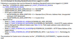

AM5708: SDK Upgrade to 08.02.01.00 , kernel crash at L3
Part Number: AM5708
Other Parts Discussed in Thread: CDCE913, AM5718
We are in the process of upgrading our SDK from version 05.03.00.07 to 08.02.01.00 for a custom board based on the TI AM5708.
However, the kernel crashes at the L3 handler during boot.
Full Booting Log:
the previous SDK boots without any problem. i have disabled dsp1 in dts file. what was the problem in L3 handle ?
Thanks you in advance.

[ 0.000000] Hit pending asynchronous external abort (FSR=0x00001211) during first unmask, this is most likely caused by a firmware/bootloader bug.

[ 0.036076] omap_hwmod: l3_main_2 using broken dt data from ocp
[ 0.053471] thermal_sys: Registered thermal governor 'fair_share'
[ 0.053479] thermal_sys: Registered thermal governor 'bang_bang'
[ 0.053490] thermal_sys: Registered thermal governor 'step_wise'
[ 0.053500] thermal_sys: Registered thermal governor 'user_space'
[ 0.054305] cpuidle: using governor ladder
[ 0.054336] cpuidle: using governor menu
[ 0.068924] omap_l3_probe...................................

  • Hello Mahesh,
    This is explained in the TRM section  14.2.3.8.5 Example for Decoding Standard/Custom Errors Logged in L3_MAIN .
    You can read more about this here --> 14.2.3.8 L3_MAIN Interconnect Error Handling
    There are also existing threads which expand on what could be potentially be the issue, like for example increasing the size of shared memory - https://e2e.ti.com/support/processors-group/processors/f/processors-forum/761621/linux-am5728-44000000-ocp-l3-standard-error-master-mpu-target-dsp1_sdma-read-at-address-0x00000000-data-access-in-user-mode-during-functional-access.
    My first recommendation would be to take care of the U-boot errors that usually will create issues at the time of kernel boot.
