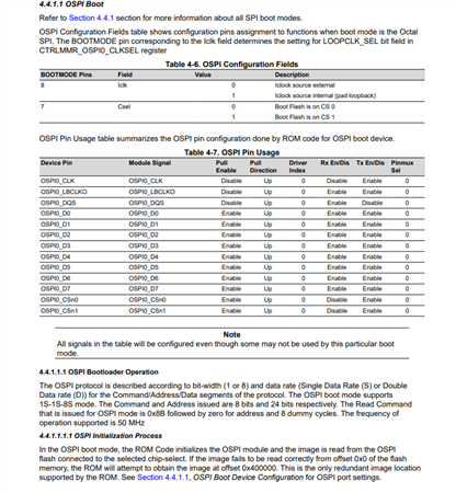

  • Hi Ted,
    I am assuming you are referring to the 1S-1S-8S flow as mentioned here:
    Please also let me know the value of bootmode pin 8. For bootmode pin 7 I am assuming it is set to 0.
    Vaibhav
  • Hello Viabhav,
    Here's the customer's setting
     xSPI BOOT mode,SFDP enabled
     pin7 - 0
    pin8 - 0
    pin9 -  1
    Overall  boot mode pin
    Bit 0 ->                     ->15
    1000 1110 0100 0000
     under this,
     read SFDP with 1S-1S-1S. after that mode will be changed into 8D-8D-8D.
    Ted

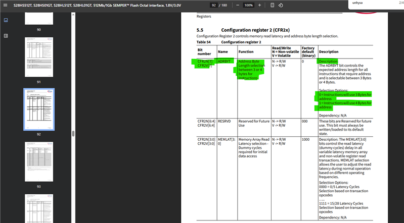

  • Hi Ted,
    I have understood now, that the bootmode used is xSPI bootmode where 1s-1s-1s is initial and switch to 8d-8d-8d is made, hence booting takes place.
    This also implies that since it is starting in 1s-1s-1s so the flash should be set in 3 byte addressing mode, but if it is in 4 byte addressing mode to begin with, then the booting will not even start at all.
    The bit I am talking about is:
    Vaibhav
  • The bit you highlighted has 0 value on factory reset
    so do you mean customer needs to check the bit whether it has set to 1 accidentally or not?
    or they need to special care when they writing the image?
    for example, some part with 3byte address and the other with 4byte address?
    Sorry for asking you about other company's device but please help.
    Ted
  • Hi Ted,
    About this, let me give you a background of how ROM operates. So before booting ROM does not performs a reset of the flash for xSPI boot mode, currently only for Serial NAND bootmode the ROM issues a reset but not for other bootmodes.
    Now talking about the following:
    The answer would be a yes.
