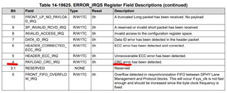

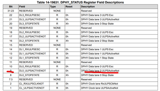

  • Hi Tom,
    What specific questions do you have regarding those two registers? Please refer to the Cadence CSI-Rx driver regarding how those registers are configured.

  • 30101028 = 0x00020910
    This indicates CRC error:
    30101048 =  0x00222206
    This indicates some issues with D-PHY data lane:
