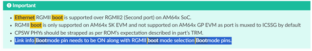

We would like to setup the boot options for the AM6442 with eMMC as primary boot and Ethernet as backup boot. We have been testing on the SK-AM64B evaluation board.
We're seeing the same issues as what is described in the thread: "SK-AM64B: Cannot boot via Ethernet as backup boot mode."
That thread is locked so I can't comment on it, I was wondering if there's any update on a fix for this issue?
