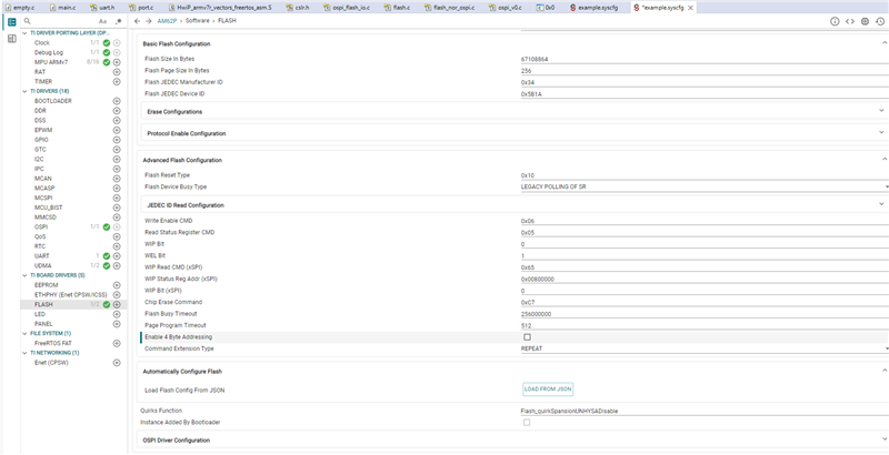

            How do I know which mode to use either phy or Tap? I saw that in the sysconfig flash_spansionquirk function is added. Is that still required? I am using winbond w25q128jv. Do you have any sysfs flash configuration example for this part?
  • Hi Shibi,
    flash_spansionquirk
    Not required as that function addresses those flash parts which have a hybrid vs Uniform mode. If your flash does not have these modes, then you can remove this quirk function else I can help you setup the quirk function in case these modes exist for your flash part.
    To understand hybrid vs Uniform mode please refer my FAQ here: https://e2e.ti.com/support/processors-group/processors/f/processors-forum/1492859/faq-am62x-am62px-am62d-q1-am64x-am243x-4kb-sector-erase-fails/5734123#5734123
    Apart from this,
    I would encourage you to read through: https://www.ti.com/lit/ds/symlink/am623.pdf#page=202
    Let me know after reading if you have the same doubt or you need more clarification. I will help you on this.
    I currently do not have the SysConfig Flash Configuration for this flash. But I have the configurations for W25Q256JV. Please check with the flash vendor on how much similar W25Q256JV is with the one you are using w25q128jv. If they are similar on configuration terms, I can share the configurations for the W25Q256JV flash.
    NOTE: I have the 1S-1S-4S protocol settings for the W25Q256JV flash.

  • The SBL ospi_linux_multistage1 is reading wrong jedec id from NOR flash.
    ERROR: Flash_norOspiReadId:859: man id 43 devid 1CFD where it should be 0xEF and 0x7018.
    I have attached below the configuration I used.

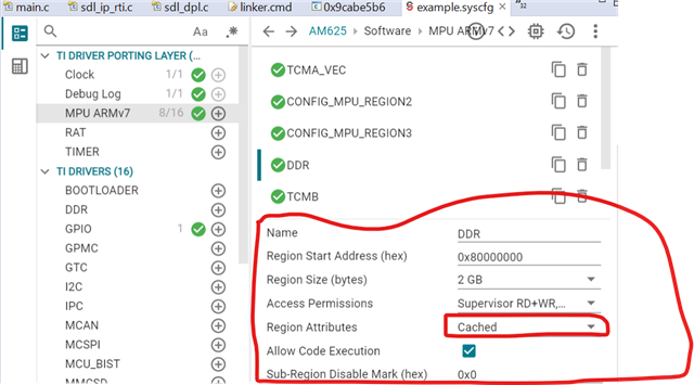

    Now I have narrowed down. The x509 header is read using OSPI read direct using memory mapped to spi nor. But I suspect that it is not happening. Am I missing any setting.
    Let us start by checking the MPU ARMv7 configurations. This section is present under SYSCONFIG of the application. Can you check if the region 0x60000000 is defined in the application, if yes, can you share a screenshot of the setting.
    Looking forward to your response.
    Vaibhav
  • I am using mcu_plus_sdk_am62x_10_00_00_14/ and /sbl_ospi_linux_multistage/sbl_ospi_linux_stage1/ example. Attached below are the changes done to the example.syscfg. The dev id and manufacturer id could be read after increasing the divider to 8 from 4.
    0x600000000 has be configured in the syscfg.
    mpu_armv710.$name = "CONFIG_MPU_REGION9";
    mpu_armv710.allowExecute = false;
    mpu_armv710.size = 9;
    mpu_armv710.attributes = "Device";
    mpu_armv710.baseAddr = 0x2800000;
    mpu_armv711.$name = "FSS0_DAT_REG1";
    mpu_armv711.baseAddr = 0x60000000;
    mpu_armv711.size = 27;
    mpu_armv711.attributes = "Device";
    mpu_armv711.allowExecute = false;
    Not able to understand completely though, but is the region for 0x60000000 marked as Cached?

    But syscfg tool always set 4B addressing to be true
    To eliminate this, we can unselect the option here in SysConfig. Please see the screenshot below:
    Notice how it is unchecked hence the 4 Byte addressing will not be set. Moreover with the flashFixUpQspiBoot being called correctly with the linked implementation, will reset the flash. Once the flash is reset, it means it will automatically be in 3 Byte addressing mode.
    Hope my explanation helps on all the above points.

    This is not expected, I tried using the same combination of the SDK along with the SysConfig, I am able to see the 4 B addressing option there.
    Al you would need to do is expand the "Advanced Flash Configuration" tab and then you will be able to see that option. Let me know if you are able to find it, if not, please send me a screenshot of the FLASH section in your application's SysConfig.
    Vaibhav
  • Apologize. I found that.

    Can you please go ahead and make the following change?
    Set the ddrCopy value to 1 as shown in the snippet above.
    After this is done rebuild the libraries and the application as well.
    Vaibhav

    Did you try setting the ddrCopy variable to 1 and testing out further after rebuilding successfully?

  • Hi Swargam,
           Thanks for joining the thread. I noticed that the data I am writing to the RAM is not properly written. Because if I write and read, at many offset the data is matching with what was written.
    I did a small write-read test with length 54016. I am writing 0xDEADBEEF to the memory.  First few offsets in the memory retains the data correctly.
    Is this something to do with RAM configuration? Cache is enabled in this memory region.

  • Hello Shibi ,
    You can confirm either the above memory is cached or not by checking the below memory region.
    Mostly the DDR memory is cached.
    If this memory is cached, then after the DMA we need to perform the cache_invalidation, then only the CPU will be able to see the proper content of the memory.
    Anil.
  • Cache is enabled in this memory region.
    Lets disable cache for this region and see the progress.
    Vaibhav
