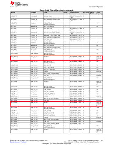

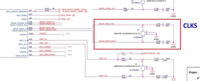

    The value is calculated as below
    Value = <Clock Frequency in MHz> * <Required Time duration in seconds>
    The crystal frequency is 19.2 MHZ If you are using TI EVM it is not 25 MHZ
    You can calculate value by 19.2MHZ * 20 ms

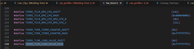

    TLDR register should be loaded with FFFF FFFF - Value(in Hex)

  • Dear Tarun,
    1. Yes, I just downloaded the psdk and build the binaries, so I think I am running the default example right.
    2. I am not sure how to know the TLDR register is loaded with FFFF FFFF, but I think the default example is set to right value?

  • Dear Tarun,
    1. No, I just reduced the default value by two zeros (reduced by 100 times), so is it not allowed that the value cannot be divided by 19.2 ? I thought it was just the time that was not so accurate(won't impact on other functionality)?
    2. I am using J721S2XSOMXEVM as CPU board and J721EXCPXEVM as common processor board. I think the clk is also 19.2 MHz?
