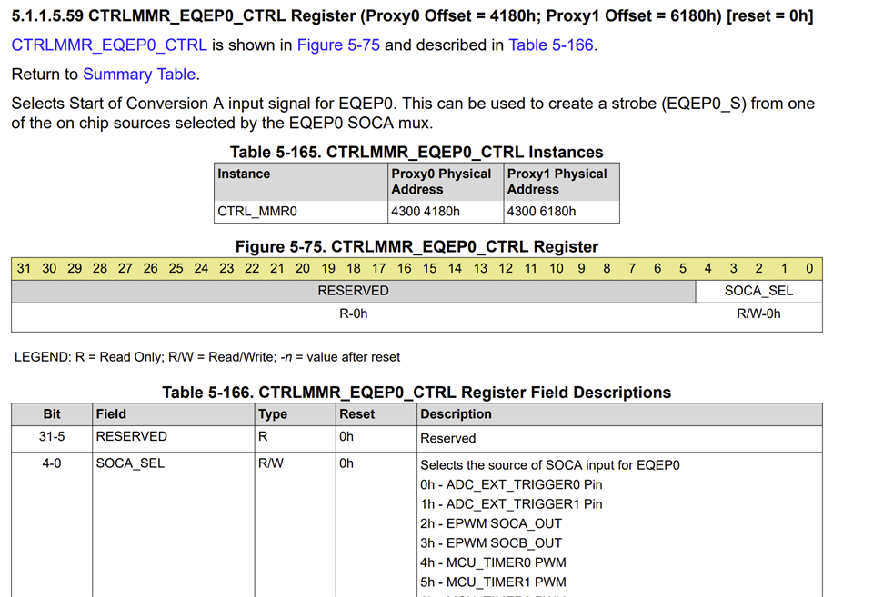

    Do I need to configure any crossbar or internal routing explicitly, or is this handled automatically?
    In general, if you select EPWM SOCA as the strobe source for eQEPs modules, and after configuring CTRLMMR_SOCA_SEL to point to EPWM0_ADCSOCA I believe we should be ok. However, let me double check, if we need to call any specific API.

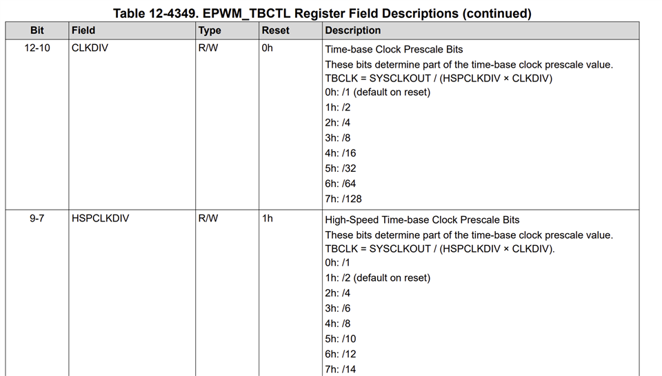

  • Hi Miyako, let me go one by one your requirements.
    1) Generate a 10Hz EPWM signal.
    For this I would suggest you use example from MCU+SDK as a starting point. AM243x MCU+ SDK: EPWM Duty Cycle
    One cavate it that currently our selection for scalers is not the correct/optimal one for low frequencies. Our developers are working on that and this will be fixed in a future MCU+SDK release.
    For now, just FYI: [EXT_SITMPUSW-81] MCU+ SDK: EPWM_tbTimebaseClkCfg does not choose the optimal pre-scaler combination - Software Issue Report (SIR)
    One solution is to use maximus hspClkDiv and lspClkDiv values to ensure TBPRD is not overflowing 16-bit as explained in below E2E:MCU-PLUS-SDK-AM243X: ePWM inaccuracy at low frequency? - Arm-based microcontrollers forum - Arm-based microcontrollers - TI E2E support forums
    Another solution is to get the optimal values as a customer posted here:  AM6422: MCU+ SDK: EPWM: EPWM_tbTimebaseClkCfg does not choose the optimal prescaler combination - Processors forum - Processors - TI E2E support forums

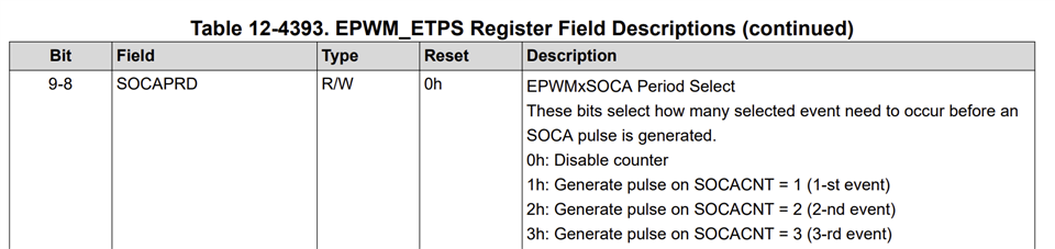

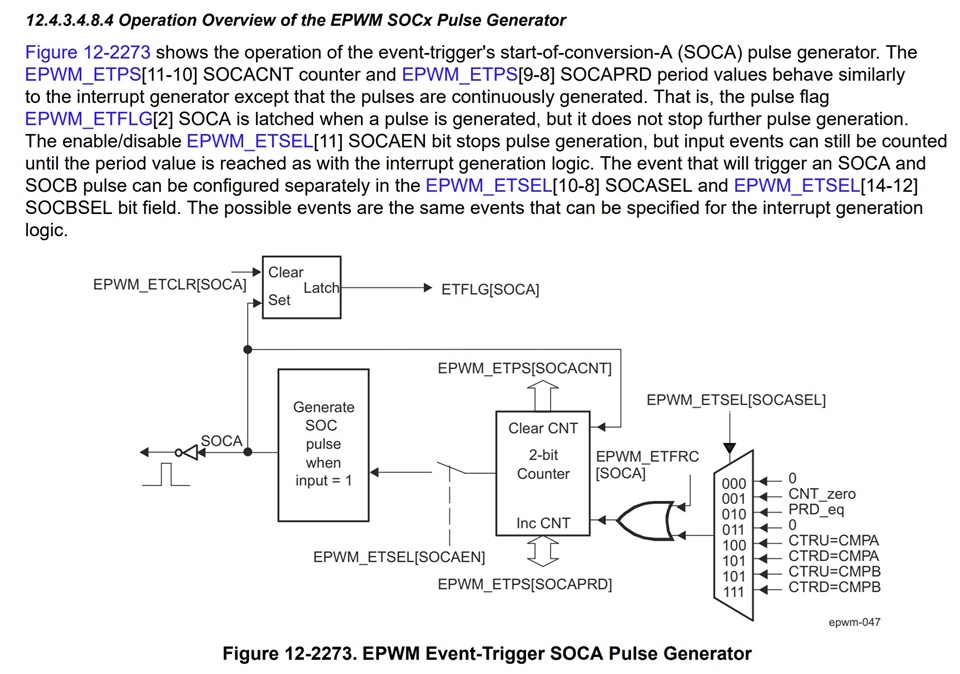

  • 2) Use ADCSOCA from ePWM as an internal trigger
    We don't have API's in our MCU+SDK for configuring SOCA, but mainly the ideas to setup below registers
    EPWM_ETSEL[SOCAEN] =1 to enable SOCA output
    EPWM_ETSEL[SOCASEL] 2h to enable event time-base counter equal to period (PRD_eq event)
    EPWM_ETPS[SOCAPRD] = 1h: to generate pulse on SOCACNT = 1 (1-st event)
    below few screenshots from our TRM with some additional information.

  • Hi Paula, thank you for your helpful response.
    I understand that the current scaler selection may not be optimal for low frequencies like 10Hz. I haven’t tested it yet, but I’m considering using a slightly higher frequency, such as around 60Hz, to see if it works more reliably with the current SDK.
    * Is there a known minimum frequency threshold above which the ADCSOCA trigger and eQEP strobe latch work reliably?
    * Are there any recommended workarounds or manual scaler settings that could improve behavior at lower frequencies?
    * Would it help to use a different ePWM module or clock source?
    I’d appreciate any guidance or suggestions you might have. Thank you again for your support!
  • Hi Miyako,
    I am not aware of any test done in this front so no sure
    You can try to use maximum hspClkDiv and lspClkDiv values and see if it works ok for you

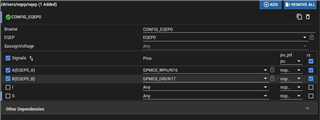

  • Hi Paula, Thank you for your continuous supports.
    When connecting a signal from ePWM via SOCA to the eQEP STROBE input, is it okay not to assign any physical pin for the STROBE signal(as shown in the picture below)?

    1. If I do not need to use the ADC conversion result, is it still necessary to configure the ADC module (e.g., prescaler, mode, enable) just to use it as a trigger path?
    2. Is it necessary to configure CTRLMMR_ADC0_CTRL.TRIG_SEL or any other CTRLMMR settings? If so, could you please explain how to configure them properly?
