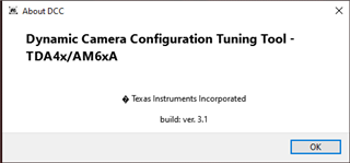

But as far as the IMX462 is a low-light sensor with amazing capabilities, I wanted to push the borders, and try to add Gamma correction and WDR+CFA, but in the tool, this is not available for RAW10, only RAW12+. I am using the DCC tool build version 3.1  . Maybe that is the problem?
