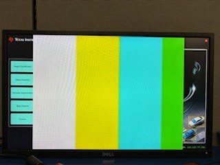

AM62A7: tiovxmultiscaler ROI didn't work
Part Number: AM62A7
Other Parts Discussed in Thread: AM67A, SYSCONFIG
SDK ver 10_00_00_08
I previously updated gsttiovxmultiscaler  plugin following
AM62A7: Gstreamer kmssink delay question - Processors forum - Processors - TI E2E support forums
I run this command
gst-launch-1.0 videotestsrc is-live=true num-buffers=10000 ! \
"video/x-raw,format=NV12,width=1280,height=720" ! \
tiovxmultiscaler name=multi src_0::roi-startx=0 src_0::roi-starty=0 src_0::roi-width=640 src_0::roi-height=480   \
multi. ! "video/x-raw,format=NV12,width=320,height=240" ! queue ! \
kmssink driver-name=tidss sync=false skip-vsync=true
and this
tiovxmultiscaler name=multi src_0::roi-startx=100 src_0::roi-starty=100 src_0::roi-width=640 src_0::roi-height=480   \
The screen display same picture
Please help resolve this issue as soon as possible, as our project has now entered a critical phase.
  • Hi Jason,
    I'm seeing the effect of ROI on my side. What's your screen size?
    Jianzhong
  • Hi Jianzhong
    My screen is 1920x720
    BR,
    Jason

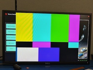

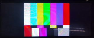

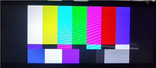

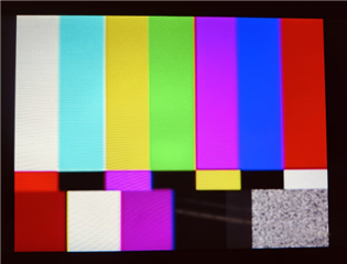

  • Jason,
    Everything works as expected on my side. Please see below logs and pictures. Can you change a screen and try again?
    1. No cropping:
    2. Cropping 640x480 from (0,0):
    3. Cropping 640x480 from (100,100):
    4. Cropping 640x480 from (200,200):
    tiovxmultiscaler name=multi src_0::roi-startx=200 src_0::roi-starty=200 src_0::roi-width=640 src_0::roi-height=480   \
    Jianzhong

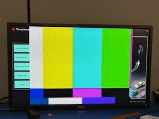

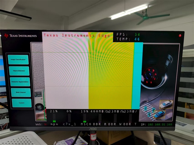

  • Hi Jianzhong
    I followed your instructions step by step and here are my results.
    1. No cropping:
    The other two commands also failed to crop properly.So I suspect there might be an issue with my multiscaler plugin.
    I previously posted on the forum to fix an issue, and followed the instructions to update both /opt/edgeai-tiovx-modules/src/tiovx_multi_scaler_module.c and its header file. I also modified this function in /opt/edgeai-gst-plugins/ext/tiovx/gsttiovxmultiscaler.c
