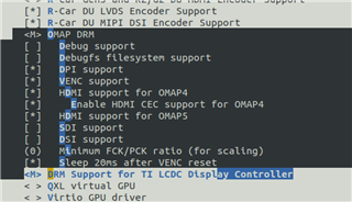

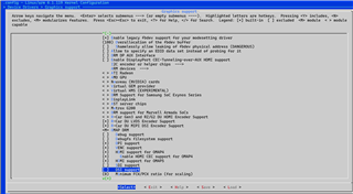

The following are enabled in the kernel's .config
CONFIG_DRM=y
CONFIG_DRM_OMAP=y
CONFIG_OMAP5_DSS_HDMI=y
CONFIG_DRM_TILCDC=y
CONFIG_DRM_PANEL_LVDS=y
CONFIG_DRM_PANEL_SIMPLE=y
CONFIG_DRM_PANEL_EDP=y
CONFIG_DRM_PANEL_OSD_OSD101T2587_53TS=y
CONFIG_DRM_DISPLAY_CONNECTOR=y
CONFIG_DRM_LVDS_CODEC=y

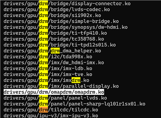

trying to open device 'omapdrm'...failed
Why is it failing ??
