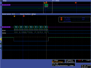

J721EXCPXEVM: SPI TX will truncate the transmitted message.
Part Number: J721EXCPXEVM
1. DUT: Device in use is the Jacinto J721e EVM carrier board with the GESI board extension.
2. Processor core: I'm developing on the mcu2_1 R5F core.
3. OS: I'm running RTOS for the OS.
4. SDK version: I am currently using only the SDK/PDK (ti-processor-sdk-rtos-j721e-evm-10_01_00_04) for my libraries and calls.
5. Hardware setup: I have SPI3 pins on the GESI board (J16 #13 - CLK; J5 #12 - D0, #4 - CS1) connected to an oscilloscope.
6. Software: I am attaching an example source code with which I can produce the problem. This has a .c file with the SPI setup and instructions; a CMakeLists.txt file is included to show you the build configuration.
Besides this running on mcu2_1 R5F, there's the sci server set up on mcu1_0.

    uint32_t xfer_len = SPI_MSG_LENGTH;
    Osal_delay(500);
    // Attempt a transfer
    uintptr_t addrMasterTxBuf = (uintptr_t)masterTxBuffer;
    uintptr_t addrMasterRxBuf = (uintptr_t)masterRxBuffer;
    bool transferOK = true;
    memset(masterRxBuffer, 0, sizeof(masterRxBuffer));
    memset(masterTxBuffer, 0, sizeof(masterTxBuffer));
    memcpy(masterTxBuffer, "TEST1234", 8);
    while (1)
        SPI_Transaction   transaction;
        transaction.count = xfer_len;
        transaction.arg = (void *)&terminateXfer;
        transaction.txBuf = (void *)addrMasterTxBuf;
        transaction.rxBuf = (void *)addrMasterRxBuf;
        transferOK = SPI_transfer((SPI_Handle)spi, &transaction);
        if (!transferOK)
            UART_printf("Error in SPI transfer\n");
        else
            UART_printf("SPI transfer successful.\n");
        Osal_delay(1000);

7. Expected behavior: It should transmit the number of bytes that I pass to transaction.count.
8. What does happen: It does not. In this case, it's truncating the message by a byte. Other code elsewhere gets the last five or for longer messages, the last fifteen chopped off.
9. Other boards: I have not yet tested on other boards.
10. Frequency: Happens every time I load a new image.
11. Diagnosis/debugging: I've tried changing the size of the message, truncation happens at any size. Changing the transaction.count does increase it, but if I send a 64 byte message, seems silly to tell it that it really is a 65 byte. In other code, this (the size) isn't always as predictable (sending the entire buffer of 128 bytes resulted in 113 bytes only being sent).
12. Logs, etc.
O-Scope output for this:

    In the thread
    https://e2e.ti.com/support/processors-group/processors/f/processors-forum/1526811/j721exsomxevm-transmitting-data-over-spi3-and-spi6-only-transmits-one-byte
    You mentioned all the Tx related issues has been solved for SPI3 and SPI6. Right ? what changed now?
    Tarun Mukesh
  • You mentioned all the Tx related issues has been solved for SPI3 and SPI6. Right ?
    Solved for transmitting more than one byte, but there's several other issues that went unanswered.
    • Why does enabling FIFO only transmit one byte, even if we have the right chip select?
    • There is still some kind of event, interrupt, or similar that cuts off the message. What is doing this?
    • Why doesn't callback get called in callback mode?
    In lieu of answers for those questions, I've moved on.
    what changed now?
    I am now transmitting more bytes, and noticed the short-changing. I have also moved to channel 1 with CS1, because chip select is indeed necessary.
  • Here is something I've observed: I've started debugging, rebuilt the libraries for debug (modified optimization with -O0) otherwise a lot of stuff gets optimized out. I found by placing a breakpoint at line 901 of SPI_v1.c (ti-processor-sdk-rtos-j721e-evm-10_01_00_04/pdk_jacinto_10_01_00_25/packages/ti/drv/spi/src/v1/SPI_v1.c)
            if ((SPI_MASTER      == chObj->spiParams.mode) &&
                (MCSPI_SINGLE_CH == hwAttrs->chMode))
                /* Force SPIEN line to the inactive state.*/
                McSPICSDeAssert(hwAttrs->baseAddr, chNum);
    and continuing will print out the entire message, with or without FIFO enabled. I modified this code and commented out the "McSPICSDeAssert" line and tried without the breakpoint, and it prints out the entire message.
    Something with putting the SPIEN to an inactive state is truncating these messages! Why does this truncate the messages, and is there a workaround?
    You can use interrupt mode , right ?
    In interrupt mode, master driver enables TX empty, RX full and end of word count interrupts. slave driver enables RX full interrupt. The TX/RX data are handled in the ISR.
    In polling mode, master driver continuously writes 1 byte TX data to TX FIFO followed by reading 1 byte RX data from the RX FIFO until all the data are transferred. slave driver continuously reads 1 byte data from the RX FIFO followed by writing 1 byte TX data to TX FIFO until all the data are transferred.
    Obviously if you inactive the SPIEN then transmission will not happen at that time that's basic SPI protocol. After full transmission only this deassert will be called.
    In Interrupt mode it will ensure the Deassert is called in ISR and after complete transmission only this will be called without truncating data.
    This underlines that you are facing timing issue and Deassert is happening before the transmission is successfully done.So ensure the Deassert happens after the whole message is transmitted.
