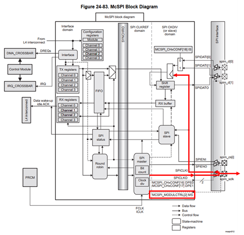

    First, the pad settings are as follows:
    CTRL_CORE_PAD_SPI1_SCK = 0x00000000
    CTRL_CORE_PAD_SPI1_CS0 = 0x00000000
    CTRL_CORE_PAD_SPI1_D0 = 0x00000000
    CTRL_CORE_PAD_SPI1_D1 = 0x00040000
    According to the datasheet, the MUX value was set to 0. Among the four SPI1 pins, we configured all except D1 as output, since they serve output functions. D1 (MISO) was configured as input.

    Afterward, based on the pad and register settings you provided, we reconfigured as follows:
    CTRL_CORE_PAD_SPI1_SCK = 0x000C0000
    CTRL_CORE_PAD_SPI1_CS0 = 0x00060000
    CTRL_CORE_PAD_SPI1_D0 = 0x000C0000
    CTRL_CORE_PAD_SPI1_D1 = 0x000C0000
    MCSPI1_CH0CONF = 0x381C0FC0
    After applying these settings and physically connecting MOSI and MISO for a loopback test, the communication was successfully verified.
    Thank you.
  • We then continued testing with these settings.
    However, with this configuration, we were unable to receive SPI signals from the FPGA connected to the actual MCU.
    While further reviewing the register configuration, we examined the McSPI Block Diagram and came to a plausible inference:
    We believe the reason McSPI is not functioning correctly under this configuration is as follows.
    Referencing the McSPI Block Diagram, it shows that the Shift Register uses an internal clock when transmitting data.
    However, for receiving data, the clock source comes from the SCLK pin input.
    This suggests that the SCLK pin is not controlled by the DPE0/DPE1 (data line selection) settings.
    Instead, its direction (input/output) is determined by the MS (Master/Slave) bit field in the Module Control Register.
    As a result, it is possible to configure the SCLK pin to allow both input and output (e.g., pad configured as input, MS bit set for master mode to output SCLK).
    In this configuration, the SCLK signal output from the SPI master can be immediately looped back into the input buffer and used as the receive clock for the RX buffer.
    Consequently, we found that all other settings could remain as before, and enabling just the Receive Enable bit field in CTRL_CORE_PAD_SPI1_SCK was sufficient to make the SPI communication function correctly.
