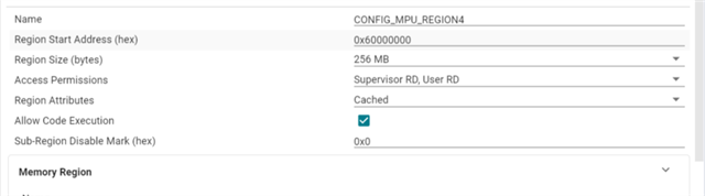

    I am using OSPI Flash with CA53.
    When the Flash_open function is executed with CA53, the WDT->ESM->SOC reset of CR5 does not work properly and the system does not reboot.
    If the Flash_open function is not executed, the system reboots correctly.
    It seems that the call to Flash_open is the cause. (Flash_open function is flash.c)
    Do you know what the cause is? I'd like to resolve this as soon as possible.
    Kiyomasa Imaizumi.
  • Additional note.
    After performing Flash_open on CA53, I performed Flash_reset on CA53 within 10 seconds before the WDT reset began, and it rebooted correctly.
    If the CA53 was left in Flash_open, it did not reboot when the CR5 WDT reset occurred.
    In fact, I use CA53 in Flash_open state.
    In this situation, how can I reboot correctly even if the CR5 WDT times out?
    Kiyomasa Imaizumi.

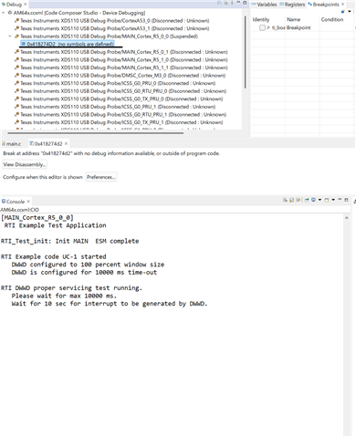

  • Additional note.
    In the above case where the CR5 was unable to complete the WDT reset and did not reboot, I attached to the CR5 in CCS using the XDS110 debugger.
    As shown below, it pointed to an address that was not in the memory map of the CR5 project, such as 0x41822048.
    What happens if the WDT times out in CR5 while CA53 is in Flash_open state?
    Kiyomasa Imaizumi.

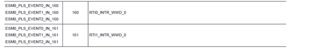

  • Hello Kiyomsasa Imaizumi,
    The RTI0 is dedicated to A53cluster 0.
    To route the RTI0 interrupt to ESM then we need to set to the 160th bit and not the 162 bit.
    So, try the configuration below with the A53 core and see if this works or not.
    SDL_ESM_config RTI_Test_esmInitConfig_MAIN =
     .esmErrorConfig = {0u, 3u}, /* Self test error config */
     .enableBitmap = {0x00000000u, 0x00000000u, 0x00000000u, 0x00000000u,
                      0x00000000u, 0x00000001u,
          /**< All events enable: except timer and self test  events, */
         /*    and Main ESM output.Configured based off esmErrorConfig to test high or low priorty events.*/
     .priorityBitmap = {0x00000000u, 0x00000000u, 0x00000000u, 0x00000000u,
         /**< Configured based off esmErrorConfig to test high or low priorty events. */

  • Hello Swargam Anil.
    I'm using RTI8 with CR5 and WDT.
    Not CA53.
    In the sample program (sdl_rti_example_uc1_am64x-evm_r5fss0-0_nortos_ti-arm-clang.zip), the flash is run by the CR5 core.
    CA53 is unrelated.
    Not CA53.
    CA53 is unrelated.
    After executing Flash_Open with the CR5 core, I'm hoping that a reset will be performed by the WDT 10 seconds later.
    However, the reset did not occur.
    I booted the sample program from RAM using CCS.
    When I stopped the program more than 10 seconds after loading it, the execution address was incorrect (0x418274D2).
    What's going on?
    However, if Flash_Open is not executed, the program reboots correctly, so I've determined that the cause is related to the flash.
    Kiyomasa Imaizumi.
    Thank you for your reply.
    I deleted MPU_REGION4 in sysconfig and rebuilt.
    When I executed RAM from CCS, Flash_Open was successful.
    However, the WDT reboot did not occur after 10 seconds had passed.
    The address stopped in the debugger at that time was 0x41827504.
    The situation has not improved.

    The Flash Module operates without a WDT.
    Reading and writing to the flash is possible.
    I don't understand why the address becomes ROM0 when it stops.
    My only guess is that something internal is happening between the reset and the SBL reboot.
    I simply stopped it at a random timing in CCS Debug after 10 seconds had passed.
    I'm not sure what the cause is.
    As you can see from the sample program, no flash operations are performed other than Flash_Open.
    Kiyomasa Imaizumi.
