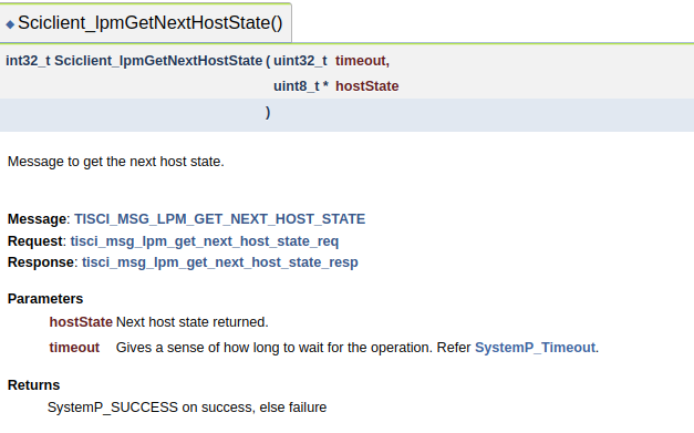

    Apologies for the delayed responses here.
    1) Did you resolve the issue, or are you still debugging?
    2) Is this related to the other e2e threads with the low power mode cycling tests, where sometimes after coming back up out of low power mode, the M4F stops responding to the low power mode transition message from Linux? Or is this related to a different test?
    3) "This issue becomes more frequent after waking up from MCU ONLY mode sleep." ---> Please tell me more about this. Does the issue ONLY occur after going into MCU ONLY low power mode, and then come back up out of low power mode? Or does the issue sometimes occur during regular Linux runtime, without going into a low power mode?
    4) What have you done to debug what the M4F core is doing right before it enters a bad state?
    Nick

  • Hi experter:
     we have found more debug information here:
    1. we use a SOC APP to comunicate with M4F by rpmsg.(you can use rpmsg_char_simple instead)
    2.  Enter MCU ONLY mode
    3. MCU wakeup the SOC by IPC way in 10 seconds later.(must suspend for a while, if only 1 seconds, this happend hardly)
    4.  repeat 2 & 3 steps until it cant wake up the SOC, i use a suspend script to do this as show bellow.
    5. at this time, i guess the IPC channel happend something wrong, as a result, it cannot wakeup SOC by IPC way.
    6. as IPC  wakeup way does not work,  we use USB0 wake up instead.
    7. after the SOC was wakeup to run, we can our APP with RPMSG recevied  a return value from 'select' means timeout. BUT we can still send msg to MCU, as the 'send' function did not return error and MCU did recieved the message.

    in my oppinion:
     the first error happend at  [  537.023842]  where output:
                  >  k3-m4-rproc 5000000.m4fss: k3_m4_suspend: timedout waiting for rproc completion event
    at this time , the IPC has been wrong. so we cannot wakeup by IPC in this suspend/resume cycle,  then I use USB disconnect/connect to wakeup,
                 >  ti-sci 44043000.system-controller: wakeup source: 0x70, pin: 255, mode: 1, time: 0
     and we can see in SOC running status:
                > [  537.527250] [17:56:15.226] mng: no keep-alive msg received from MCU, last keep-alive time : 530585ms, current time: 537303ms
    this means out APP have not received from MCU. As i did not stop the suspend script, then it repeat suspend and resume untill i stop at [  549.332041]
    then we recevied "rx: no data" in 3 seconds later, we first try to reopen the rpmsg by usespace rpmsg lib to restore it but failed,
    another 3s elapsed, we stop and restart MCU by /sys/class/remoteproc/remoteproc0/state.
    as you see in [  558.276285], it report timedout to stop means we still can received from MCU.
               >  k3-m4-rproc 5000000.m4fss: k3_m4_rproc_stop: timedout waiting for rproc completion event
    when the MCU start again, and our APP reopen the rpmsg after the MCU running, it restore comunications at [  564.940432]

     we found   the reason of " k3-m4-rproc 5000000.m4fss: k3_m4_suspend: timedout waiting for rproc completion event"  is the MCU running status is blocked at code bellow:
    status = Sciclient_lpmGetNextHostState(SystemP_WAIT_FOREVER, &nextHostState);
    when We send "RP_MBOX_SUSPEND_SYSTEM" msg to MCU from SOC, MCU have recived it actually, But when MCU wants to get the next host state by call the SCI API up, it cannot go on. So MCU has no chance to excute SOC_triggerMcuLpmWakeup yet. that is why IPC look like do not work.
    So maybe we should  focus on why the API "Sciclient_lpmGetNextHostState" really block forever !

    (4) How about disable "SystemP_WAIT_FOREVER" in Sciclient_lpmGetNextHostState()?
    Ref. https://software-dl.ti.com/mcu-plus-sdk/esd/AM62X/latest/exports/docs/api_guide_am62x/group__SCICLIENT__FMW__LPM__IF.html#ga57860e66a2f13065b44e7e255d066d36

    We have clarified the issue of "k3-m4-rproc 5000000.m4fss: k3_m4_suspend: timedout waiting for rproc completion event".
    The cause is that the M4 core is stuck at "status = Sciclient_lpmGetNextHostState(SystemP_WAIT_FOREVER, &nextHostState);".
    We now plan to place the reply to ipc_notify in the callback function.
    May we ask if there will be any other unknown issues with this approach?
    And why isn't the R5 core replying to the requests from the M4 core?

  • Hello Walter,
    I see that in your Sciclient_lpmGetNextHostState(), you replaced SystemP_WAIT_FOREVER with 0x50.
    Just to confirm: in the "not working" case, were you using SystemP_WAIT_FOREVER? Or were you using 0x50?
    Nick
  • Hi Nick,
      Under abnormal circumstances, this parameter is SystemP_WAIT_FOREVER.
  • Hello Walter,
    Thank you for confirming.
    Right now, I suspect something is going wrong in the DM R5F
    That makes me suspect that the DM R5F core is getting into a bad state. Then the DM R5F core is not responding to Sciclient_lpmGetNextHostState(), so then the M4F does not respond to the Linux low power transition request.
    Let's double check your M4F code just to make sure
    Please send your full M4F test code to me through Gibbs. That way I can look it over and make sure there are not any obvious issues.

  • Checking the DM R5F current state
    After the low power mode transition fails, do you start to see any messages in your terminal about mailbox communication failing? If so, that could be a sign that the DM R5F has entered a bad state. In that case, the mailbox messages would be failing because the DM R5F was not replying to them.
    Did you still see low power mode fails after changing the M4F timeout value to 0x50?
    If the DM R5F is going into a bad state, then the low power mode transition would still fail, even after you add a timeout value of 0x50. Please attach the terminal output if you are still seeing a low power mode transition fail after the M4F replies back.
    Nick
  • Hi Nick,
    1.Due to information security policies, we cannot distribute the entire code externally.
    In previous replies, I have already posted the key code modifications.
    2.After changing it to 0x50, AM62 no longer gets stuck at "Sciclient_lpmGetNextHostState()";
    instead, it can proceed with sleep and wake-up cycles normally (including successful subsequent sleep-wake stress tests).
    3.Previously, when RPMSG communication failed, we could restore it by restarting M4 using the command
    "echo 'stop' > /sys/class/remoteproc/remoteproc0/state" (since M4 was stuck in wait_forever).
    However, now when RPMSG communication fails, the command "echo 'stop' > /sys/class/remoteproc/remoteproc0/state" can no longer be sent to M4.
    We have not connected the R5 serial port to check logs. Currently, we are testing the issue where
    RPMSG communication fails intermittently under high-temperature conditions.
