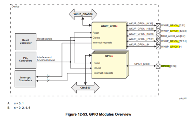

Hi Team,
In DRA821U4, defined ADC pins can be assigned as GPIO, as we not using ADC interface and want to use ADC pins as GPIO. As per datasheet. it is not showing that adc pins multiplexing with GPIO

ADC pins can be used as GPI, not GPIO.
CTRLMMR_MCU_ADC0_CTRL defines ALL of the ADC pins as digital input (or analog input)
PADCONFIG[84:77] define that these 8 inputs are driven to GPIO0 or GPIO1
GPIO[76:69] will show the values from the pins
