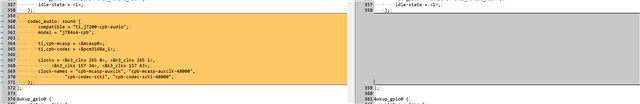

 		idle-state = <1>;
-	codec_audio: sound {
-		compatible = "ti,j7200-cpb-audio";
-		model = "j784s4-cpb";
-		ti,cpb-mcasp = <&mcasp0>;
-		ti,cpb-codec = <&pcm3168a_1>;
-		clocks = <&k3_clks 265 0>, <&k3_clks 265 1>,
-			 <&k3_clks 157 34>, <&k3_clks 157 63>;
-		clock-names = "cpb-mcasp-auxclk", "cpb-mcasp-auxclk-48000",
-			      "cpb-codec-scki", "cpb-codec-scki-48000";

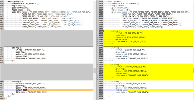

@@ -1049,6 +1034,14 @@ exp2: gpio@22 {
 				  "ENET1_I2CMUX_SEL", "ENET1_EXP_SPARE2", "ENET2_EXP_RESETZ",
 				  "USER_INPUT1", "USER_LED1", "USER_LED2";
+		p8-hog {
+			/* P10 - PM_I2C_CTRL_OE */
+			gpio-hog;
+			gpios = <8 GPIO_ACTIVE_HIGH>;
+			output-high;
+			line-name = "CTRL_PM_I2C_OE";
 		p13-hog {
 			/* P13 - CANUART_MUX_SEL0 */
 			gpio-hog;
@@ -1057,11 +1050,19 @@ p13-hog {
 			line-name = "CANUART_MUX_SEL0";
+		p14-hog {
+			/* P14 - CANUART_MUX2_SEL1 */
+			gpio-hog;
+			gpios = <14 GPIO_ACTIVE_HIGH>;
+			output-low;
+			line-name = "CANUART_MUX2_SEL1";
 		p15-hog {
 			/* P15 - CANUART_MUX1_SEL1 */
 			gpio-hog;
 			gpios = <15 GPIO_ACTIVE_HIGH>;
-			output-high;
+			output-low;
 			line-name = "CANUART_MUX1_SEL1";

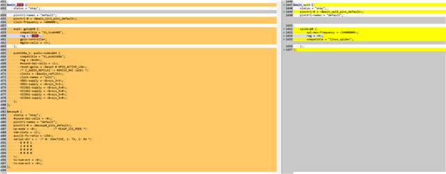

-&main_i2c3 {
+&main_spi5 {
 	status = "okay";
+	pinctrl-0 = <&main_spi5_pins_default>;
 	pinctrl-names = "default";
-	pinctrl-0 = <&main_i2c3_pins_default>;
-	clock-frequency = <400000>;
-	exp3: gpio@20 {
-		compatible = "ti,tca6408";
-		reg = <0x20>;
-		gpio-controller;
-		#gpio-cells = <2>;
-	pcm3168a_1: audio-codec@44 {
-		compatible = "ti,pcm3168a";
-		reg = <0x44>;
-		#sound-dai-cells = <1>;
-		reset-gpios = <&exp3 0 GPIO_ACTIVE_LOW>;
-		/* C_AUDIO_REFCLK2 -> RGMII6_RXC (W26) */
-		clocks = <&audio_refclk1>;
-		clock-names = "scki";
-		VDD1-supply = <&vsys_3v3>;
-		VDD2-supply = <&vsys_3v3>;
-		VCCAD1-supply = <&vsys_5v0>;
-		VCCAD2-supply = <&vsys_5v0>;
-		VCCDA1-supply = <&vsys_5v0>;
-		VCCDA2-supply = <&vsys_5v0>;
+	spidev@0 {
+		spi-max-frequency = <24000000>;
+		reg = <0>;
+		compatible = "linux,spidev";

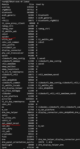

we used make linux-dts to compile it and update the dtb file to /boot/dts/ti ,
when check the /dev after reboot the board ,  we can not find a "spidev*" int /dev dir , any other changes we need to check ?
