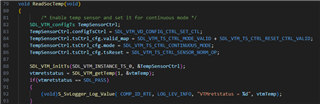

I am read the Temperature of the SOC using SDL_VTM_getTemp every 1 Second,
and the temperature read is the same regardless of the time of running and once the POR is done the temperature changes.
I am referring to the VTM example from the SDK for the configuration,
Refer to below piece of code used to read the temperature,
Please let us know any other configuration is needed to read the temperature properly,
