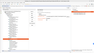

CCS version: Version: 12.4.0.00007
JTAG:XDS110
Boot mode
SW8 1000 1000
SW9 0111 0000
JTAG:XDS110
Boot mode
SW8 1000 1000
SW9 0111 0000

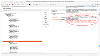

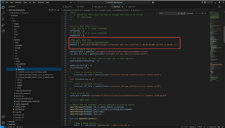

Have you updated the PDK path in the launch.js file? If not, please update it with the current PDK path in the following file:
<pdk>/packages/ti/drv/sciclient/tools/ccsLoadDmsc/j721e/launch.js
//PDK path. Edit this
pdkPath = "/home/karthikeyansaravanan/ti/ti-processor-sdk-rtos-j721e-evm-11_00_00_06/pdk_jacinto_11_00_00_21";
Karthik

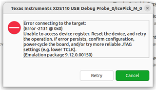

Could you please try to connect to the M3_0 core without loading any GEL files? Let us know if you are able to connect to the M3 core, and can you please share the launch.js file with me?
Karthik
