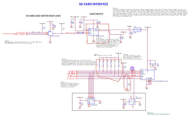

  • Hi Board Designers,
    Inputs regarding power supply
    Most CMOS semiconductor inputs are not fail-safe. So, there is a good chance the same requirement applies for the attached device. We expect the IO power rail of attached devices to be powered from the same power supply that is powering the associated AM64x IOs to prevent any sequencing issues. You will need to ensure your system implementation doesn't cause problems for either of the devices if they are not powered from the same source.

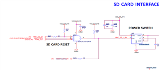

    The 3.3V power switch controlled by the three input AND gate is needed to cycle power to the SD Card and the AM62x MMC1 IO power supply. The SD Card does not have a reset input, so cycling power is the only way to reset it. You must also cycle power to the AM62x MMC1 pins anytime you cycle power to the SD Card because the SD Card inputs are not fail-safe. Having the reset capability is very important for UHS-I SD Cards because this is the only way to force the SD Card back to 3.3V mode after it was changed to operate in 1.8V mode.
    I would not recommend a direct connection to 3.3V if you plan to support UHS-I SD Cards.

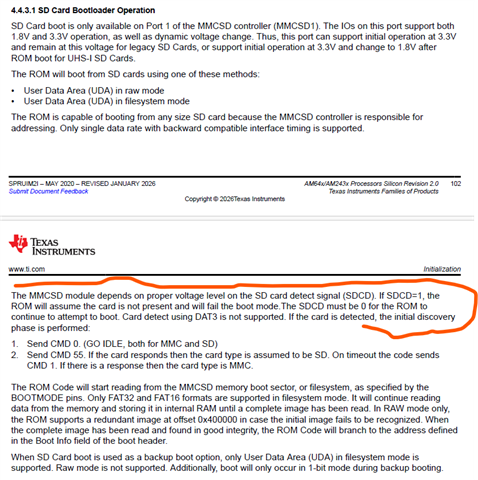

    The ROM code will use Legacy compatibility mode at low clock frequency 25MHz, and never attempt to increase frequency, regardless of the SD card capabilities.
    When using SDCD, is it possible to configure the power supply and signal level on the SDCD side to be only 1.8V?
    I'm not sure which MMC port you are asking about.
    The SDCD signal function associated with the MMC1 port is part of the VDDSHV0 IO power domain, so this signal must operate from the same power supply that is sourcing VDDSHV0.
    The SDCD signal function associated with the MMC2 port has three pin multiplexing options, where two are part of the VDDSHV0 power domain and the other is part of the VDDSHV6 power domain. The operating voltage of this signal must be from the same source being used to power the respective IO (VDDSHV0 or VDDSHV6 power domain).
    I do not understand why this is a concern. Normally the SDCD signal is only connected to switch on the SD Card slot, where the signal is pulled high with a pull-up connected to the same power rail that is powering the associated IO and the switch in the SD Card slot will pull the signal to VSS when a card is inserted. The switch doesn't care what voltage is applied to the pull-up.

    We still recommend implement a 3.3V load switch that sources the SD card and the MMC1 VDDSHV5 IO power rail with its enable controlled by a three input AND of the power on reset, AM62Ax warm reset output, and a GPIO that is pulled high until configured by software. This is needed to reset the SD card since it doesn't have a reset pin. The only way to reset an Sd card is cycle its power and the AM62Ax VDDSHV5 IO rail must be cycled at the same time to avoid non-fail-safe conditions. This implementation will reset the card anytime the system power is cycled, a warm reset is generated like in the case where a watchdog time resets the processor, or if the SD card software driver needs to reset it via a GPIO without resetting the entire system.
    The VDDSHV5 is always supplied, and the power supply of the SD card is loaded with a load switch.
    Is there a problem if the VDDSHV5 is always supplied to the SD card after SDCD is detected?
    Is it a substitute for a RESET if I put a load switch on the power supply to the SD card?
    Do I really need three inputs, SD_EN, RESETSTATz, and PORz_OUT, to power enable the SD card?
    Is it possible to achieve this with two signals, SD_EN and RESETSTATz?
    The IOs associated with both the AM62Ax device, and the SD Card are not fail-safe. This means no external circuit can source any potential greater than the potential applied to the respective IO power rail. See the "Steady-state max voltage at all other IO pins" parameter in the Absolute Maximum Ratings table in the datasheet, where the potential applied to a pin is limited to minimum of "-0.3V" and a maximum of "IO supply voltage + 0.3V".  The same limit should be applied to the SD Card pins.
    The IO power rails of attached devices need to always have the same potential applied to prevent current injection into an IO that has a potential applied greater than the limits defined in the datasheet. For example, if one device is turned on the other device must be turned on, if one device is turned off the other device must be turned off. Their IO supplies also need to track as the power source ramps up or down. The best way to ensure this condition, is to power the IOs associated with both devices from the same power source.
    For the SD Card use case, the VDDSHV5 power rail on AM62Ax, the SD Card, and any external pull-up resistors need to be powered by the load switch.
    For AM62Ax the MMC1 IOs default to an off state, so we recommend external pulls on the MMC1 signals to hold the inputs of the attached SD Card in valid logic state until the device has booted, and software configures the IOs. An external pull-down resistor is recommended for the CLK signal and external pull-up resistors are recommended for each of the CMD and DAT[3:0] signals. The external pull-up resistors should be powered from the same switched 3.3V power that is connected to the SD Card and the VDDSHV5 power rail.
    Our reset expert said the PORz_OUT would not be needed since the RESETSTATz output will satisfy all reset cases for the SD Card.
    I need to clarify my last reply. I should have said the RESETSTATz output will satisfy the power-on and warm reset functions for the SD Card. You will still need a two input AND gate to insert the software controlled GPIO reset function for the case where software needs to initiate a reset to only the SD Card.

    If a system plans to support UHS-II SD Cards on MMC1, the VDDSHV5 IO supply and the SD Card must be power cycled any time the SD Card needs to be reset since it does not have a reset pin. Cycling power to the SD Card is the only way to return an SD Card back to 3.3V operation after it was previously operating at 1.8V. UHS-II SD Cards are required to begin communications with the host using 3.3V signaling so they are backwards compatible to the requirements of a legacy host. These cards can be changed to use 1.8V signaling to achieve faster data transfer speeds. The VDDSHV5 power rail must also be switched off when the SD Card power is switched off since the SD Card input are not fail-safe.
    There are two sections of circuits on the AM62P EVM schematic that accomplish the task of controlling power to the SD Card and VDDSHV5. The circuit that controls power to the SD Card can be seen on the schematic page titled "SD CARD INTERFACE".  The circuit that controls power to VDDSHV5 can be seen in a section titled "3.3V/1.8V SD CARD SUPPLY" on the schematic page titled "PERIPHERAL POWER SUPPLY -1". Both of these circuits are turned off any time reset is asserted or the GPIO connected to "MMC1_SD_EN" is driven low. This is required to force the SD Card and the VDDSHV5 power source back to 3.3V mode after a hardware or software resets, where it must reestablish communications with the host using 3.3V signaling.
    Note: the GPIO connected to "VSEL_SD_SOC" must default to a high logic state before reset is released to ensure the VDDSHV5 power supply is operating at 3.3V when SD Card communications is first initiated. This signal is only driven low at the same time the SD Card is told to switch from 3.3V to 1.8V and it shall never be allowed to go back to a logic high state until the SD Card is powered off or reset.
    Since reset is being used to turn the SD Card off, it is not possible for the SD Card to be powered up before reset is released.  The SD Card boot code in ROM is delayed for a period of time that should be long enough for the SD Card to power up and be ready for communications.

    AM62P5-Q1: RESETSTAT and PORz_OUT for SD card power enable
    In the schematic of AM62P EVM, RESETSTATz and PORz_OUT are ANDed to the SD Card power enable signal.
    Customer also understand that RESETSTATz is also asserted when PORz_OUT is asserted.
    Is this understandig correct ?
    Is the circuit like this because the timing is slightly different when asserting?
    In that case, please tell us what  the timing between RESETSTATz and PORz_OUT.
    The system power on reset is connected to ensure the card power is forced off as soon as power is applied since this reset is expected to be valid while power supplies ramp.  The RESETSTATz is included so the SD Card is power cycled (Reset) if there is a processor warm reset source like a watchdog time-out. The GPIO is connected to allow the software driver to reset (cycle power) the SD Card.
    The RESETSTATz will not be valid until all AM62Px power rails are valid, so it is delayed relative to the system power on reset.
