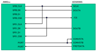

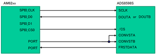

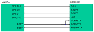

Hi All,
Can you tell me if the connection between AM62x and ADS8598S is correct?
Since a ReceiveOnly connection seems impossible, are the following two patterns correct?
・When using 2ch SPI
・Communication time will be longer, but use either DOUTA or DOUTB.
