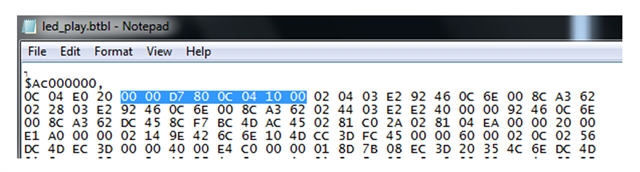

Step 3: Running hex6x Utility
Executed the following command to generate the boot table:
C:\Temp>hex6x led_play.rmd
Translating to ASCII-Hex format...
"led_play.out" .text ==> (BOOT TABLE)
"led_play.out" .cinit ==> (BOOT TABLE)
"led_play.out" .const ==> (BOOT TABLE)
"led_play.out" .switch ==> (BOOT TABLE)
led_play.btbl was generated as the led_play.BTBL file

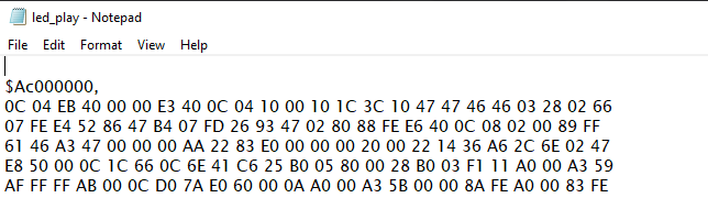

here is the content of the led_play.btbl,

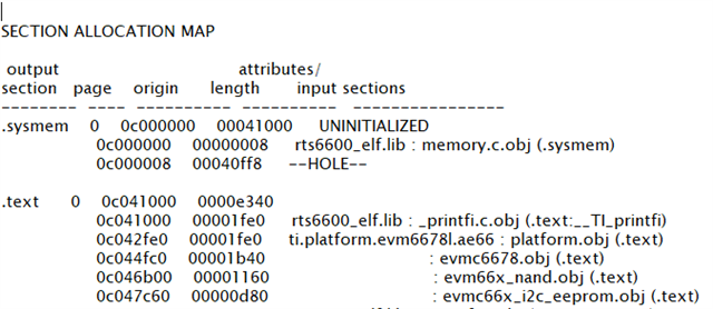

here is the content of the led_play.map,

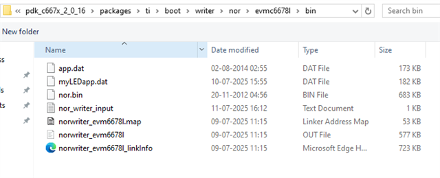

Step 5:  We copied project file form the C:\ti\mcsdk_2_01_02_06\tools\writer\nor\evmc6678l
char *input_file = "C:\\ti\\pdk_c667x_2_0_16\\packages\\ti\\boot\\writer\\nor\\evmc6678l\\bin\\nor_writer_input.txt";  // We use the path of the pdk
C:\ti\pdk_c667x_2_0_16\packages\ti\boot\writer\nor\evmc6678l\bin
 here the file of the  nor_writer_input.txt,
After generating the boot image, we proceeded with configuring the boot mode and flashing the application as outlined below:
1 Configured Boot Mode DIP Switches
  • Set the boot mode DIP switches on the EVM to No Boot / EMIF16 Boot Mode as per the hardware configuration guidelines.
  • No Boot   off, on, on, on| on, on, on, on | on, on, on, on | on, on, on, on
2.Copied Boot Image to NOR Writer Directory
  • Copied the generated .dat file to the directory:
    writer\nor\evmc66xxl\bin\

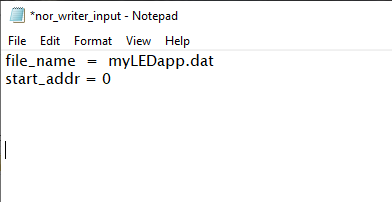

3. Updated NOR Writer Configuration
  • Modified the file norwriter_input.txt located in:
  • Made the following changes as per the reference image:
    • Set file_name = myLEDapp.dat
    • Set start_addr = 0
4. Connected EVM Using CCS
  • Launched CCSv9 (v9.3.0.00012) and opened the target configuration for the evmc66xxl emulator.
  • Connected to Core 0 successfully.
5. Loaded NOR Writer Program
  • Loaded the program:
    writer\nor\evmc66xxl\bin\norwriter_evm66xxl.out
  • Applied the evmc66xxl.gel script to initialize DDR memory in CCS.
6. Verified DDR Memory Initialization
  • Opened Memory Browser in CCS:
    View → Memory Browser
  • Monitored memory starting at address:
    0x80000000

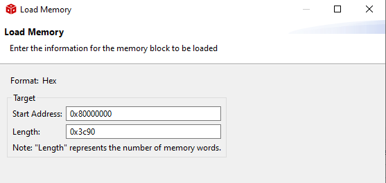

7. Flashed Boot Image to DDR Memory
  • Loaded the myLEDapp.dat file to address 0x80000000:
    • In CCS, selected Load Memory and specified the starting address as 0x80000000.
Here is the some screenshots for your reference.
