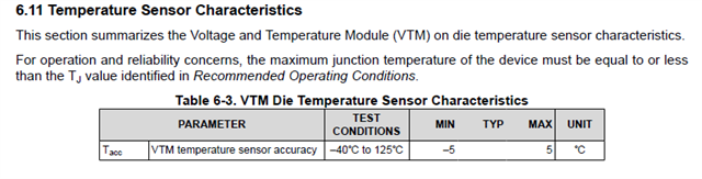

How accurate is the junction temperature value return by vtm_get_temperature?

Hello NNiculina
Thank you for the query.
Please refer below.
This table is from the AM62A7 data sheet.
The same will be updated for the Am6442.
