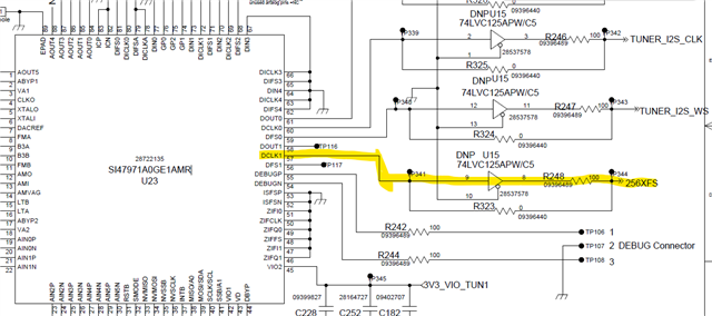

We are using the TI processor SDK ti-processor-sdk-linux-am62xx-evm-11.00.09.04. We are customizing the BSP Audio configuration for our custom hardware. Below is the pin configuration for McASP interface:

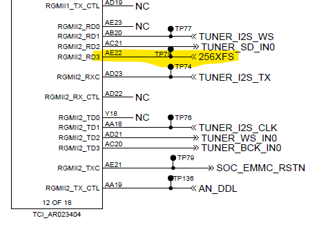

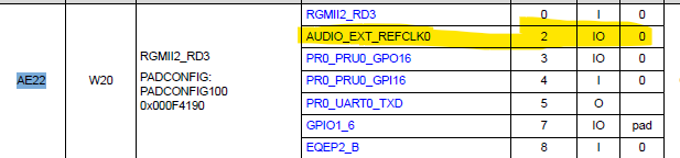

RGMII2_RD3 (AE22) 256XFS Input AUDIO_EXT_REFCLK0
RGMII2_RD1 (AB20) TUNER_I2S_WS Input MCASP2_AFSR
RGMII2_RXC (AD23) TUNER_I2S_TX Input MCASP2_AXR1
RGMII2_TD1 (AA18) TUNER_I2S_CLK Input MCASP2_ACLKR
RGMII2_RD2 (AC21) TUNER_SD_IN0 Output MCASP2_AXR0
RGMII2_TD2 (AD21) TUNER_WS_IN0 Output MCASP2_AFSX
RGMII2_TD3 (AC20) TUNER_BCK_IN0 Output MCASP2_ACLKX

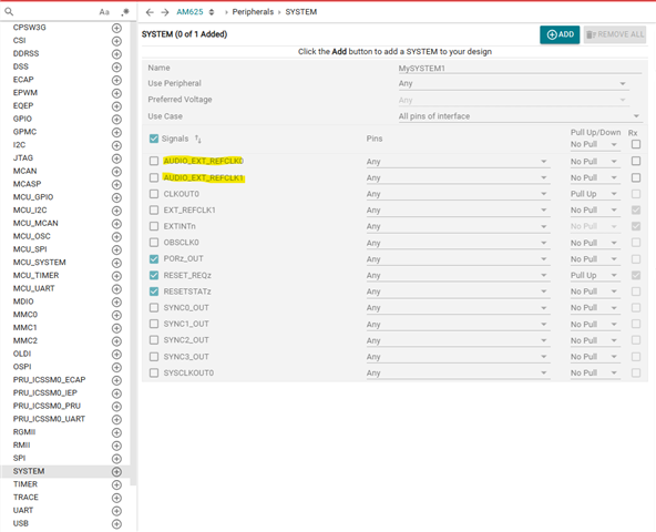

Here, We are trying to configure the pins in TI systool. The configuration for AUDIO_EXT_REFCLK0 pin not visible in TI systool.

Please let me know why this pin is not showing in the TI Systool. Also, we want to know how this AUDIO_EXT_REFCLK0 will be used by the Codec driver (we are using dummy driver). Is there any properties need to set it in DTS?
Here, there is some clocks going input to the SOC and vice versa. How the data will be sampled? Whether with this AUDIO_EXT_REFCLK0 clock for both the clocks.
