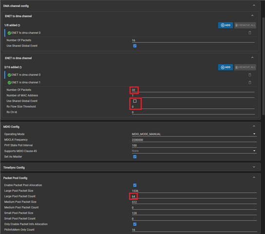

I tested the example using the default SysConfig settings and a modified SysConfig based on the settings shown in the ICSSG SWITCH section of the documentation.
Default SysConfig:
Modified SysConfig:
Other modification:
  • Disabled UART debug logs and enabled CCS debug logs
  • In ti_power_clock_config.c, I commented out the line: DebugP_assertNoLog(status == SystemP_SUCCESS); in Module_clockSetFrequency() because SOC_moduleSetClockFrequencyWithParent() was returning SystemP_FAILURE. This workaround worked fine for other examples like ipc_rpmsg_echo_linux.

  • Hello Teja,
    thank you for your response and for testing the behavior.
    Following your suggestion, I attempted the system reset as outlined below. First, I powered off and on the board and then started a debug session using F5. Unfortunately, the result remains unchanged from earlier tests.
    I also tried a different approach: after powering on the board, I started the debug session and then manually performed a system reset on the R5 core running the enet_lwip_icssg example using CCS.
    After clicking on System Reset, the MAIN_Cortex_R5_0_0 thread transitions from HALTED RUNNING HELDINRESET RUNNING. However, no debug logs are printed after the reset and all breakpoints are ignored. The board is unresponsive to the ping command, as outlined in the documentation. This suggests that the reset didn't resolve the issue.
    While debugging, I also noticed several threads labeled ICSS. I attempted to start these manually but this did not have any impact either.
    When I switched to the Release build configuration, the logs changed slightly. The system successfully initializes most components, including EnetUdma, Icssg, and EnetPer. However, the final step, Enet_open(), still fails, triggering the same assertion as in the Debug mode:
