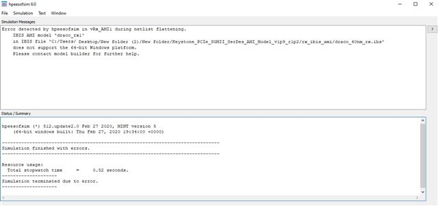

Thank you for providing me with the download link.
However, as you can see in the attached photos, it seems that the models can not been run in 64 bits windows.
Could you please advise on this matter?
Oliver
Hi Oliver,
This thread gives some tips:
TMS320C6678: Error in IBIS AMI simulation for SRIO
As stated there ... unfortunately we have no ability to modify the IBIS AMI models for 64b windows support.
Kyle
