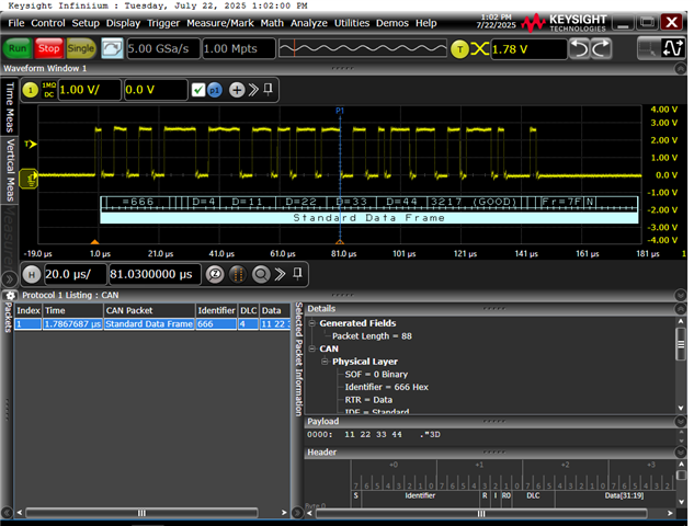

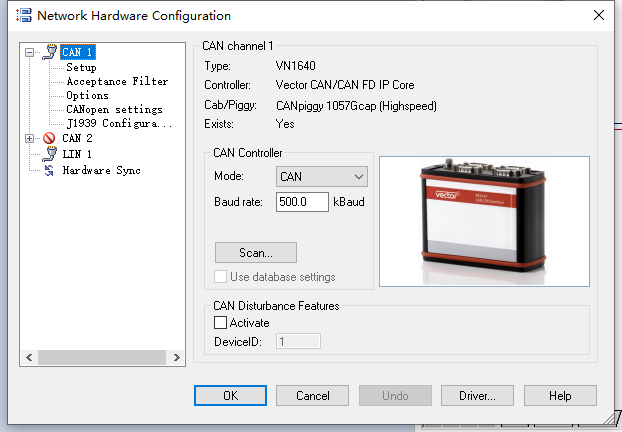

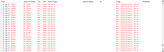

在标准CAN模式和CANFD模式下,都只有在仲裁段位1 Mbps时才可以通信,设置为其他值,比如500kbps等都会导致通信失败。
以下是CANOE提示的错误信息

  • Hi, In standard CAN mode and CANFD mode, communication can only be done when the arbitration segment is 1 Mbps, and setting other values, such as 500kbps, will cause communication failure.
    The following is the error message prompted by CANOE。Please help me analyze what might be causing this,Thank you!

  • Hello Takuma,
     I'm sure candump is running. I also tried to grab the waveform with an oscilloscope, and found a little abnormality, I will attach two pictures, we use two CAN (mcu_mcan0, mcu_mcan1) on the TDA4VH for spontaneous self-reception, whether it is CAN or CANFD mode, it can communicate normally, but once connected to CANOE for comparison, an error will occur, resulting in bus-off, we make sure that the baud rate and other configurations of CAN on TDA4VH are consistent with CANOE. The terminal resistors also have normal connections.I found that at the end of the CAN frame, the waveform was a bit abnormal.

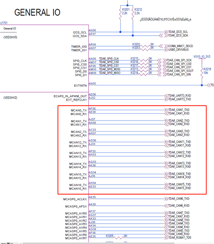

    Software should be compatible between XJ784S4GAALY and TDA4VH88TGAALYRQ1. They should both have same number of MCAN and SERDES lanes.

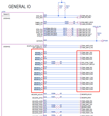

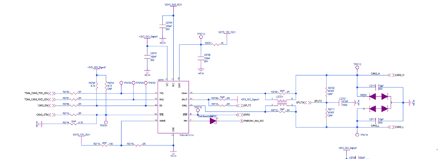

    Can you share the schematics of how the signal from SoC for MCAN is routed to MCAN pins?
    Takuma
  • Hi Takuma,
    We also use the mass-produced chip "TDA4VH88TGAALYRQ1" because the two chips are compatible with each other, and the schematic is almost unchanged compared to the "XJ784S4GAALY" chip, and the previous schematic design is directly reused.

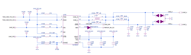

  • Hi Wzzz,
    Can you also share the XJ784S4GAALY version of below schematics?
    I am not knowledgeable with the connection for this particular CAN transceiver, but I would like to understand if there are any difference with the RXD, EN, STB, and WAKE pins. I see the RXD pin has a pull-up resistor which typically is not necessary, and WAKE is pulled down.
    Takuma
  • Hi Takuma,
    I will attach the schematic design of the chip "XJ784S4GAALY", as you said, compared to the previous principle, it does add a pull-up resistor to the RX pin of the CAN transceiver. Could this be the cause of the communication failure?
    Wzzz

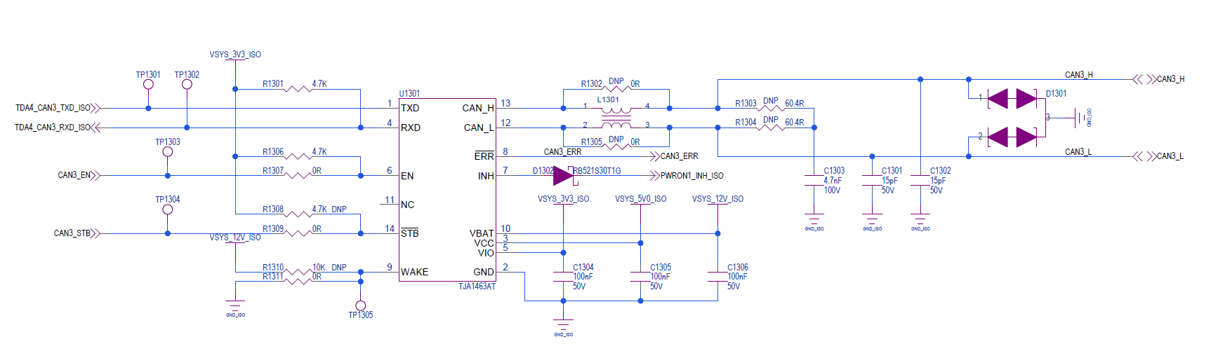

  • Hi Wzzz,
    As an experiment, could the pull-up resistor be removed?
    I am not aware of a requirement to pull up the RX line for CAN, so I am not sure what the effect is for including the resistor or removing the resistor. However, since the issue is happening only on the RX, and a difference between working and non-working system is the pull-up resistor on the RX line, removing the pull-up would be a good experiment.
    Takuma
  • Hi Takuma,
    I can try to see if I can remove the pull-up resistor on the RX and test it. However, not only RX is a problem, but also TX, as I described before and attached pictures, I use TDA4VH as the transmitter and CANOE as the receiver, CANOE cannot receive data correctly, only when TDA4VH and CANOE are configured in CANFD mode, and the baud rate is set to 1Mbps, the communication is normal. In standard CAN mode, there are problems with both TX and RX, you can look through the images I provided earlier, this should help us identify the problem as soon as possible.
    Wzzz
  • Hi Wzzz,
    I took a look at the schematics a bit more and noticed that the CAN transceiver used in old working and new non-working system are different. So, I do not think this is an issue with sample vs mass-produced chips. Instead, I think it is more reasonable to suspect the issue is due to the hardware changes done on the new board related to the CAN transceiver.
    So please, continue with the RX pull-up resistor change. I also noticed that the VBAT related connection is slightly different, and there is slight difference with the termination due to SPLIT termination.
    Takuma
  • Hi Takuma,
    We tried removing the pull-up resistor on the RX for testing, and it was still the same as before. For the change you said about the split terminal, our CAN transceiver has changed from TJA1043 to TJA1063, it seems that TJA1063 does not need a split terminal, and we also tried to change the TJA1063 to the original TJA1043 transceiver for testing, but it still can't communicate.
    Wzzz

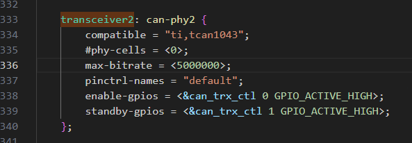

  • Hi Wzzz,
    Can you share the devicetree used for TJA1043 and TJA1063?
    Takuma
  • Hi Takuma,
    I'll attach the device tree configuration for both transceivers.The number of devices we TJA1043 and TJA1063 use is the same, nothing has changed.
    TJA1063:
    TJA1043:
    Wzzz

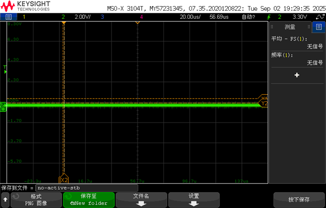

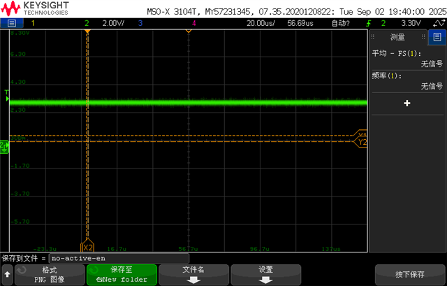

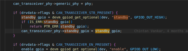

  • Hi Wzzz,
    The change with standby and enable gpios is significant. What is the reason for commenting out standby gpio for working TJA1043 case?
    As shown below, not defining standby-gpios should cause an error in the transceiver driver, so I assume there were changes done to the Linux kernel driver. There may be some changes in the kernel driver which might be conflicting with TJA1063 since ti,tcan1043 and ti,tcan1042 both use the same kernel driver.
    Takuma
  • Hi Takuma,
    I think the purpose of the standby and enable configuration here is to control these two pins and get the transceiver into a working state. The 1043 device tree notes standby because standby is raised by default and does not need to be controlled.
    Wzzz
  • Hi Wzzz,
    You are right, the standby/enable is using the optional API, so error should not necessarily be triggered. Hardware-wise, the old and new board looks to have standby floating and not pulled up or down, so it is a bit strange though.

  • Hi Takuma,
    During testing, I controlled the standby and enable pin states of the transceiver via GPIO and measured them with a multimeter to ensure that the pin state was properly controlled. As I said before, the TDA4VH can communicate with tools such as CANOE at certain baud rate settings, so I think the transceiver should be in a normal working state. In addition to CANOE, we also tested it with ZCANPRO, and the results were the same as before.

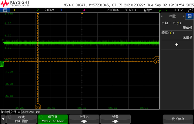

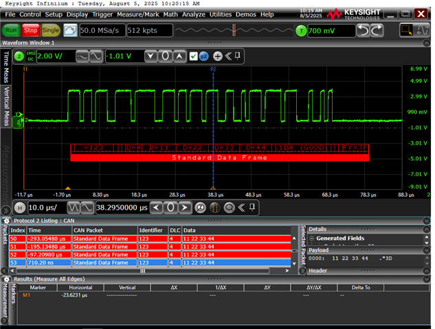

  • Waveform in non-operational mode:
    Waveform in normal operating mode:
    Normal TX signal in working mode:The two CAN channels of the TDA4VH are connected to each other, and there is no abnormality in the TX signal.
    Abnormal TX signal in operating mode:When connected to CANOE or an external device, the end flag of the TX signal is abnormal.
    RX signal in working mode:As you can see, the waveform of the RX is correct, but the data is not received using candump.

  • Hi Wzzz,

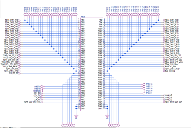

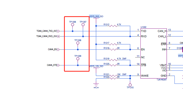

    1. Can you please confirm where in the schematic you're probing when capturing the TXD signal in the working and failing case?
      1. Can you probe at various points in the TXD signal path and share the results (eg. TP6505 at SoC, TP1301 after the digital isolator and before the CAN transceiver)? We would like to know how this signal looks at various points before and after the digital isolator in its path.
      2. Same as above for RXD signal.
    2. Why is there a pull-up resistor on the RXD line between the digital isolator and CAN transceiver?
    3. Does the TDA4 SoC report any MCAN errors in the failing case?
      1. Please refer to MCAN Protocol Status Register section in MCAN Debug Guide
    Both pre-production part and production part are the same silicon revision so there are no differences expected with the MCAN.
    EDIT: Few more items to check if you could please.
    1. Are there any electrical shorts between TXD and RXD signals?
    2. Is TJA1463 VIO stable?
    3. What is J6503? Is this a connector?
  • Hi Mark,
    1.These signals are measured at the test point between the isolator and the transceiver, as shown in the figure below.
    2. The pull-up resistor on the RX is reserved by us. We also tried removing this pull-up resistor for testing, but there was no change. Will this pull-up resistor have any impact on communication?
    3. I will supplement the status of these registers later.
    The answers to the several questions you supplemented are as follows.
    1. There is no short circuit phenomenon between RX and TX.
    2. The VIO power supply is stable.
    3. J6503 is a board to board connector.
    Wzzz

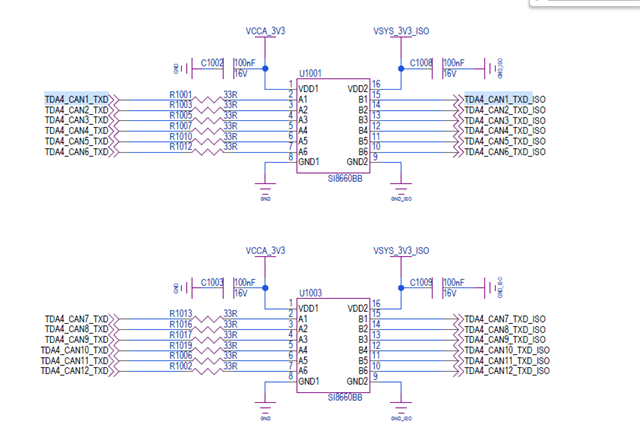

    Can you please provide TXD signal waveforms before the digital isolator?
    This pull-up resistor is likely ok. It will ensure the transceiver output's recessive state is standby or sleep mode.

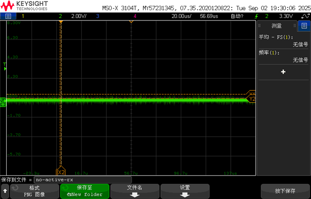

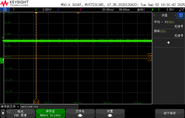

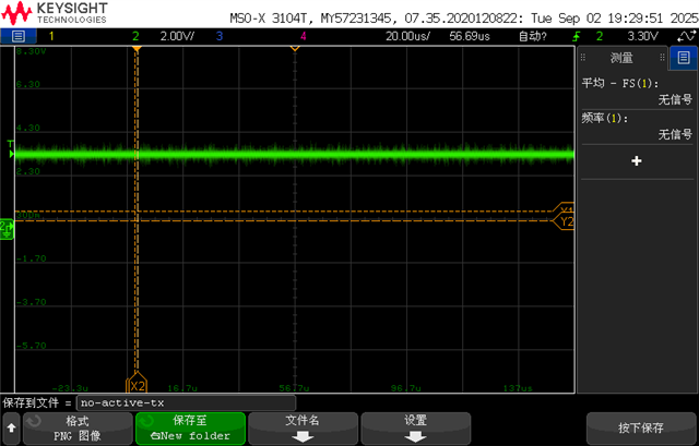

  • Hi,Takuma
    According to Mark's suggestion, we measured the TX and RX before isolation, and the results are as follows.
    TX:
    RX:
    Currently, we have tested the several forms you mentioned. The TDA4VH itself can communicate through its two CAN channels, but it cannot communicate properly with CANOE or ZCANPRO. However, CANOE and ZCANPRO can communicate normally with each other, and we have also changed the transmission rate and sampling point for testing, and both sides can communicate normally.
    For RX:
    During the testing process, we first ensure that the parameters on both sides remain consistent, but the RX still cannot receive any data.
    For TX:
    You are correct in your understanding; during the transmission process, some parts were transmitted while others were not, resulting in the bus entering a bus-off state.
    Wzzz
  • Hi Wzzz,
    Thanks for sharing the waveforms but I believe these are inconclusive without seeing the SoC transmit or receive any CAN packets. I would have expected to see something similar to probing in between the digital isolator and the transceiver.
    Mark
