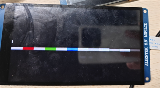

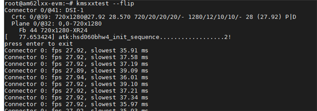

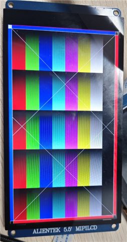

Then I can light up my screen, but it is not stable because the frame rate is only around 28 fps,The following is the display and terminal information:

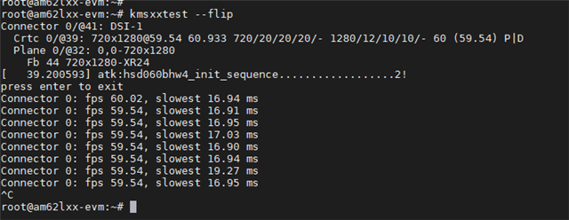

    3. To confirm fps, can you please run 'kmstest --flip' for both 28.57MHz and 60.9MHz clock?

    3,With 60MHz clock,There nothing in display.
      With 28MHz ,There  some test picture is displayed on the screen.
