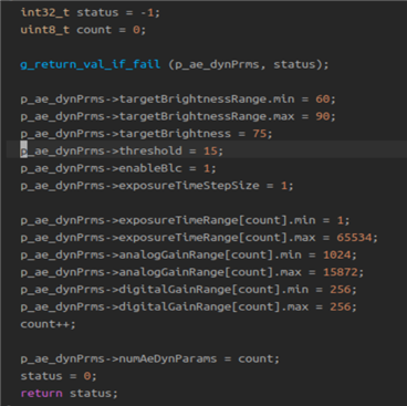

1. My camera is x3c, and since its Decompanded Bit Width is 24, I have set the WDR Gamma to 50%. However, there is overexposure when there is sunlight outdoors, as shown in the figure below.
I attempted to debug the exposure and gain settings in the AE algorithm and found that both the exposure and gain were already at their minimum values. Therefore, I adjusted the WDR Gamma to 70%, resulting in a better performance, as shown below.
However, the issue is that in indoor environments, the image becomes darker. Although the AE algorithm attempts to increase the exposure and gain, the adjustment is insufficient, resulting in a persistently dim image.I can't balance the brightness between indoor and outdoor environments. Could the experts please offer some suggestions? Thanks!
Thanks!

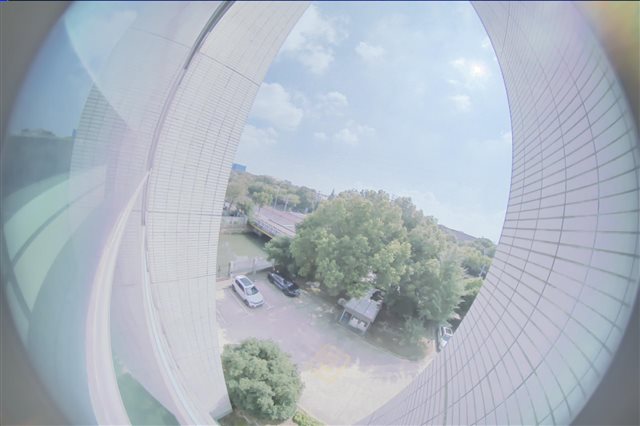

  • Hi Ying,
    Could you please share the sensor image raw image and YUV output in this case?
    What are those values?

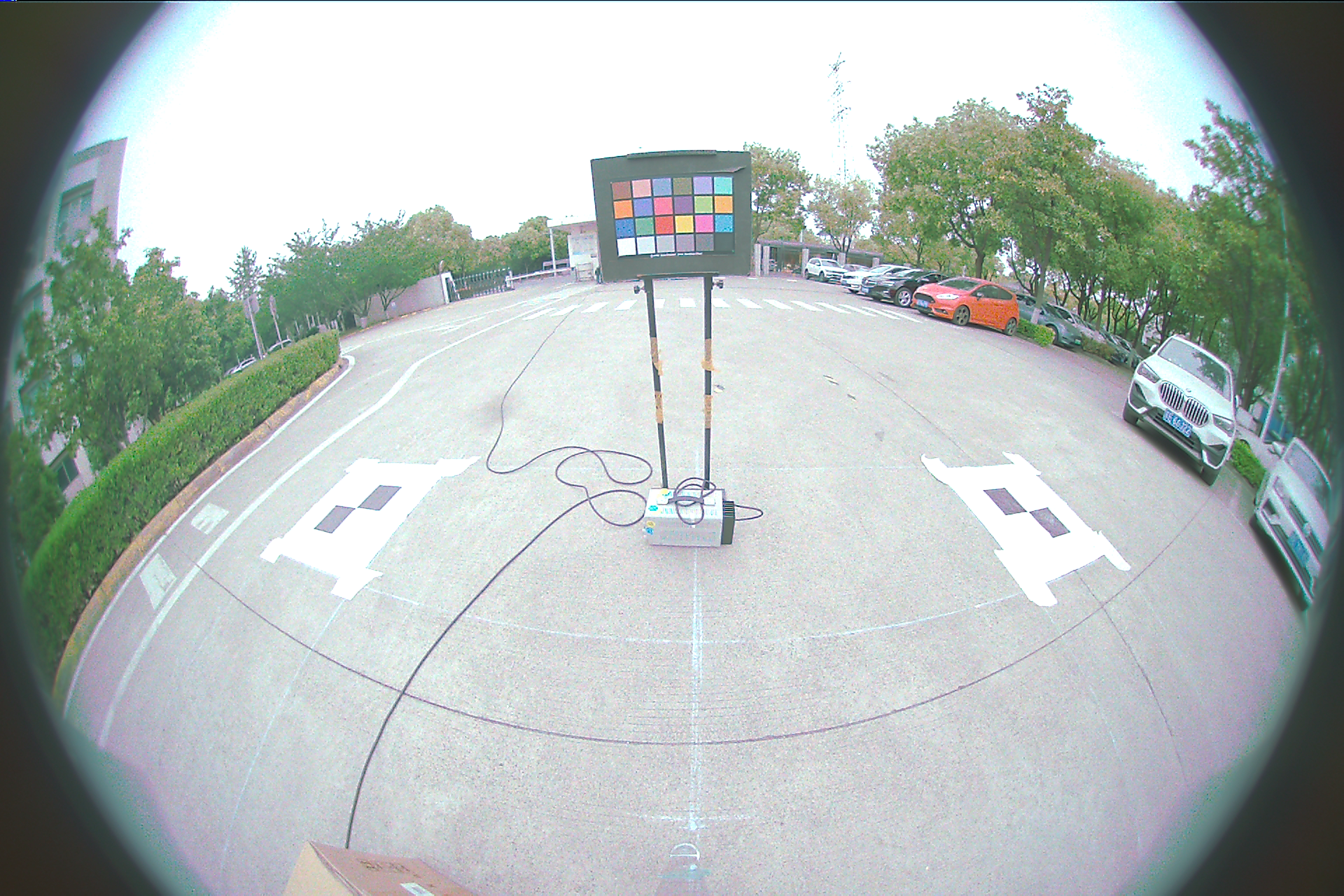

    I also started this thread. Since you didn't reply to me at that time, I created another thread. Let's communicate here from now on.(+) TDA4VM: Consultation on AE-related issues - Processors forum - Processors - TI E2E support forums
    1. The first image in the above picture and the pictures below were not taken on the same day. To summarize, when the WDR Gamma is set to 50%, the indoor brightness is normal, but the outdoor sky, clouds, etc. will be overexposed. When the WDR Gamma is set to 70%, there will be no overexposure outdoors, but the indoor area will be very dark. All the above images are YUV images, and I saved them by taking screenshots. The following are raw and yuv images.

    2. The following are my AE parameters, which I believe are correct.
    This might happen if the raw image is very bright and GLBCE settings are extreme.
    Could you please add the raw image for the outdoor scene along with the companding knee points?

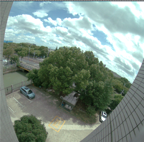

    1. These are the raw image and YUV image taken outdoors. The raw image is not overexposed, but the YUV image is overexposed.

  • 1. These are the raw image and YUV image taken outdoors. The raw image is not overexposed, but the YUV image is overexposed.
    These raw images look OK to me and YUV images should not be saturated normally.
    There might be something wrong in your VISS settings.

    1. The image generated by my Python script is shown below. It has an overall purple tint, and the light also appears purple. Could there be an issue here?
    2. As can be seen from the raw image, the light—before going through the ISP—is white and looks normal. However, in the YUV image processed by the ISP, the light has turned purple. This doesn’t seem to be a driver bug or software issue.

    I'll redescribe the phenomenon.
    1. The original image generated by "python3 ctt_def_xml_gen.py ../configs/ox03c10_properties.txt" is shown below. The indoor area has an overall purple tint, and the lights also look purple, while the outdoor area appears normal. Could this be an issue?
    2. As can be seen from the raw image, the light—before being processed by the ISP—is white and normal. However, in the YUV image processed by the ISP, the light has turned purple. This doesn’t seem to be a driver bug or software issue.

  • The original image generated by "python3 ctt_def_xml_gen.py ../configs/ox03c10_properties.txt" is shown below. The indoor area has an overall purple tint, and the lights also look purple, while the outdoor area appears normal. Could this be an issue?
    I guess you mean using the initial tuning from the python script.
    The python script does not include AWB calibration (it only gives a dummy/null one).
    So, AWB could be wrong in many cases.
    Those is the raw image are not white.
    It is just a false impression because of the WDR companding.
