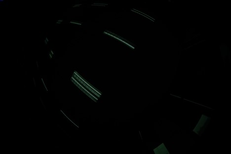

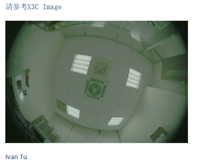

1. I asked colleagues from the camera module manufacturing department for the pictures of X3C being activated with other tools at that time. As shown in the figure, without software driver or ISP processing, the lamp appears white, which can prove that the camera module is in good condition.
2. I used the software driver and GStreamer command to save the raw image without ISP processing, and the lamp appears white.
gst-launch-1.0 -v v4l2src num-buffers=1 device=/dev/video-ox03c10-cam0 io-mode=dmabuf ! video/x-bayer, width=1920, height=1280, framerate=30/1, format=bggr12 ! multifilesink location="image-%d.raw"
Therefore, I suspect the issue is on the ISP side. What do you think I should do to find the cause?

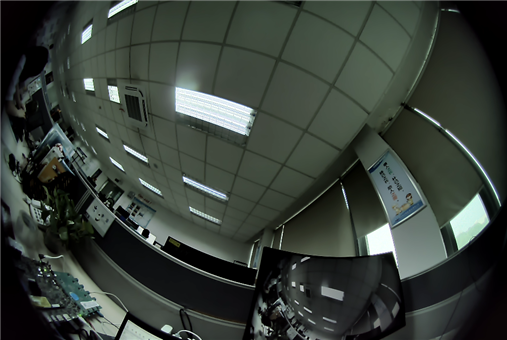

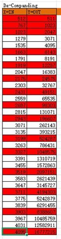

    1.After multiple tests, I've found that this seems to be an issue with the WDR decomposition extension. As shown in the figure below, if I remove the last 4 pairs of coordinates, both the indoor tone and the color of the lamps are normal. However, when these coordinates are added back, the entire indoor area, including the lamps, turns purple. How should I resolve this problem?
    Yes, this raw image looks good.
    If you feed it into ISP with proper ISP settings, the output image should look good.
    I used the gstreamer pipeline below for old SDK version.
    gst-launch-1.0 multifilesrc stop-index=0 location=/opt/edgeai-test-data/raw_images/modules_test/imx390_raw_image_1936x1096_16bpp_exp0.raw caps="video/x-bayer, width=1936, height=1096, format=rggb16" ! tiovxisp sensor-name=SENSOR_SONY_IMX390_UB953_D3 dcc-isp-file=/opt/imaging/imx390/wdr/dcc_viss_wdr.bin format-msb=11 sink_0::dcc-2a-file=/opt/imaging/imx390/wdr/dcc_2a_wdr.bin ! filesink location=output_imx390.yuv
    For latest SDK, you may need to add "wdr-enabled=true".
    https://e2e.ti.com/support/processors-group/processors/f/processors-forum/1535185/am62a7-awb-is-not-effective/5960218?tisearch=e2e-sitesearch&keymatch=wdr_enabled#
    Output color could go wrong at runtime if AWB gains get wrong or some wrong register values are sent to sensor.
    You may start with static images first for testing.

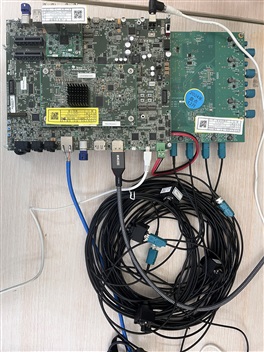

    Are you using SK-TDA4VM?
    https://www.ti.com/tool/SK-TDA4VM
     I am using the TDA4VM-EVM,  Linux EdgeAI version
    No, I am not using the SK-TDA4VM. I am using the TDA4VM-EVM. Could you please help me find the link? Thank you.

    1. I am using the TDA4VM-EVM. I don't mean to get stuck on whether I can download the EdgeAI SDK.
    2. My ultimate request is: I have modified imaging/algos/ae/src/TI_aaa_ae.c, and I want to know how to compile it so that the modification takes effect on the board. Could you understand my need?

    2. Could it be due to WDR compression? How should I troubleshoot whether it is caused by WDR?

    I did not see any companding issue in your previously shared raw images and xml files.

  • Hi Ying,
    Thanks for sharing the summary!
    So, is there a problem with my AWB gains?  Is the purplish light caused by this reason?
    If the color tint is global, then it is typically an AWB calibration issues.
    If you see most gray objects in the view are white balanced, that is typically not a problem of AWB itself.
    Local purple color around lights is typically an issue in the sensor especially when there is motion (i.e., you may only see purple color with motion).
    While the sensor internally merges multiple exposure frames together, it may create purple color artifacts especially with motion.
    Some OVT sensors may require using AWB gains in the sensor avoid those purple artifacts.
    You may check with OVT for details.
    Purple color similar to below is typically the sensor issue (or due to wrong WDR companding knee points used in ISP).
    AWB is working properly as the ceiling is white balanced correctly.
    H3A_INPUT_LSB affects both AE and AWB, but it is easy to tell if AWB is working properly (or we may simply use fixed AWB gains).
    If sensor exposure changes while you change H3A_INPUT_LSB, then purple color may look different because in-sensor HDR merge becomes different.

  • Hi Gang,
    I've been working with the OVT team over the past few days to resolve this issue.The current findings indicate that the previous sensor settings were not normalized—specifically, the actual hardware dynamic range of this camera falls short of 140dB. When deriving the original sensor data (RAW) by working backward from the final image data, the maximum brightness values must not be saturated. This saturation issue led to a deviation in the R, G, and B ratios.
    To address this phenomenon, adjustments have been made to the WDR (Wide Dynamic Range) decompanding knee points. Additionally, Pre-AWB (Pre-Auto White Balance) has been implemented based on the characteristics of the sensor's LPD (Low Power Detection) and SPD (Spectral Power Distribution). While these modifications have resulted in an improvement in the purple tint issue, it has not been completely resolved.
    1. What I would like to consult you about is this: since Pre-AWB needs to determine the current color temperature before making corresponding RGB ratio adjustments, where in the ISP can the current color temperature be obtained? Thanks!
  • Hi Ying,
    Thanks for the update!

  • Hi Gang,
    Since I cannot achieve a good AWB effect, could you please help me check if the new WDR knee point coordinates provided by OV are correct?
  • Hi Ying,
    It looks similar to normal OVT knee points.
    They are part of the sensor register initialization and OVT shall be able to confirm easily.
