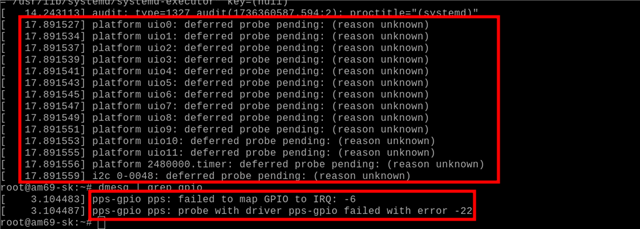

AM69: main_gpio4 fails to probe with error, "IRQ index 2 not found".
Part Number: AM69
Hello.
I am currently working on the requirement to set the CPU affinity of GPIO interrupts. (See the table below.)
As far as my knowledge goes, GPIO interrupts are managed on a per-bank basis. Not in per-pin basis.
In order to meet the requirement, it will be necessary to configure the additional GPIO modules as following table.
In order to achieve this, I enabled three more modules in the device tree file.

When I boot the kernel with this config, GPIO driver prints the following error.
[    1.712423] davinci_gpio 620000.gpio: error -ENXIO: IRQ index 2 not found
[    1.712694] davinci_gpio 630000.gpio: error -ENXIO: IRQ index 0 not found

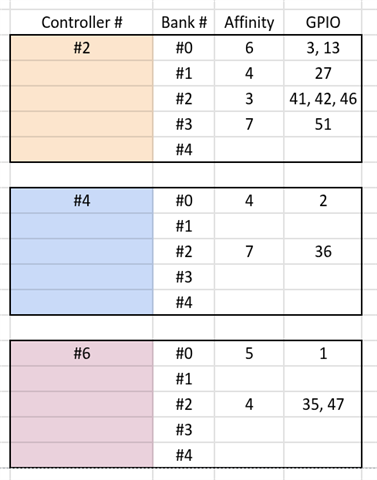

    For device tree, I've added these.
    // k3-am69-sk.dts
    &main_pmx0 {
        card_intr_pins_con_0: card-intr-pins-con-0 {
    		pinctrl-single,pins = <
    			J784S4_IOPAD(0x004, PIN_INPUT_PULLDOWN, 7) /* (AG36) MCAN12_TX.GPIO0_1 */
                J784S4_IOPAD(0x008, PIN_INPUT_PULLDOWN, 7) /* (AJ33) MCAN12_RX.GPIO0_2 */
    			J784S4_IOPAD(0x08c, PIN_INPUT_PULLDOWN, 7) /* (AE35) MCASP0_AXR7.GPIO0_35 */
                J784S4_IOPAD(0x0bc, PIN_INPUT_PULLDOWN, 7) /* (AD33) MCASP1_AFSX.GPIO0_47 */
                J784S4_IOPAD(0x0c0, PIN_INPUT_PULLDOWN, 7) /* (AD38) MCASP1_AXR0.GPIO0_48 */
    	card_intr_pins_con_2: card-intr-pins-con-2 {
    			J784S4_IOPAD(0x00c, PIN_INPUT_PULLDOWN, 7) /* (AF33) MCAN13_TX.GPIO0_3 */
                J784S4_IOPAD(0x034, PIN_INPUT_PULLDOWN, 7) /* (AJ34) PMIC_WAKE0n.GPIO0_13 */
                J784S4_IOPAD(0x090, PIN_INPUT_PULLDOWN, 7) /* (AC35) MCASP0_AXR8.GPIO0_36 */
    			J784S4_IOPAD(0x0cc, PIN_INPUT_PULLDOWN, 7) /* (AM37) SPI0_CS0.GPIO0_51 */
    			J784S4_IOPAD(0x0a4, PIN_INPUT_PULLDOWN, 7) /* (AJ36) MCASP0_AXR13.GPIO0_41 */
                J784S4_IOPAD(0x0a8, PIN_INPUT_PULLDOWN, 7) /* (AF34) MCASP0_AXR14.GPIO0_42 */
                J784S4_IOPAD(0x0b8, PIN_INPUT_PULLDOWN, 7) /* (AC34) MCASP1_ACLKX.GPIO0_46 */
                J784S4_IOPAD(0x06c, PIN_INPUT_PULLDOWN, 7) /* (AJ37) MCAN1_TX.GPIO0_27 */
    &main_gpio0 {
    	status = "okay";
    	pinctrl-names = "default";
    	pinctrl-0 = <&card_intr_pins_con_0>;
    	interrupt-affinity = <0x03>, <0x03>, <0x03>, <0x03>, <0x03>;
    &main_gpio2 {
    	status = "okay";
    	pinctrl-0 = <&card_intr_pins_con_2>;
    	interrupt-affinity = <0x40>, <0x10>, <0x08>, <0x80>, <0x03>;
    &main_gpio4 {
    	status = "okay";
    	// The driver fails to probe even without this setting.
    	// pinctrl-0 = <&card_intr_pins_con_4>;
    	// interrupt-affinity = <0x10>, <0x03>, <0x80>, <0x03>, <0x03>;
    &main_gpio6 {
    	status = "okay";
    	// pinctrl-0 = <&card_intr_pins_con_6>;
    	// interrupt-affinity = <0x20>, <0x03>, <0x10>, <0x03>, <0x03>;
    After booting the Image, Following logs are showed up.
    600000.gpio : main_gpio0
    610000.gpio : main_gpio2
    620000.gpio : main_gpio4
    630000.gpio : main_gpio6
    root@am69-sk:~# dmesg | grep gpio
    [    1.705321] davinci_gpio 42110000.gpio: GPIO-AFFINITY) no interrupt map found.

    [    1.709865] davinci_gpio 610000.gpio: GPIO-AFFINITY) set interrupt map of BANK #2 AFFIN #0x8
    [    1.709868] davinci_gpio 610000.gpio: GPIO-AFFINITY) For looping CORE : 0x1
    [    1.709870] davinci_gpio 610000.gpio: GPIO-AFFINITY) For looping CORE : 0x2
    [    1.709871] davinci_gpio 610000.gpio: GPIO-AFFINITY) For looping CORE : 0x4
    [    1.709873] davinci_gpio 610000.gpio: GPIO-AFFINITY) For looping CORE : 0x8
    [    1.709875] davinci_gpio 610000.gpio: GPIO-AFFINITY) Setting BANK #2 to CORE : 0x8
    [    1.709877] davinci_gpio 610000.gpio: GPIO-AFFINITY) For looping CORE : 0x10
    [    1.709879] davinci_gpio 610000.gpio: GPIO-AFFINITY) For looping CORE : 0x20
    [    1.709881] davinci_gpio 610000.gpio: GPIO-AFFINITY) For looping CORE : 0x40
    [    1.709883] davinci_gpio 610000.gpio: GPIO-AFFINITY) For looping CORE : 0x80
    [    1.709893] davinci_gpio 610000.gpio: GPIO-AFFINITY) set interrupt map of BANK #3 AFFIN #0x80
    [    1.709895] davinci_gpio 610000.gpio: GPIO-AFFINITY) For looping CORE : 0x1
    [    1.709897] davinci_gpio 610000.gpio: GPIO-AFFINITY) For looping CORE : 0x2
    [    1.709899] davinci_gpio 610000.gpio: GPIO-AFFINITY) For looping CORE : 0x4
    [    1.709901] davinci_gpio 610000.gpio: GPIO-AFFINITY) For looping CORE : 0x8
    [    1.709903] davinci_gpio 610000.gpio: GPIO-AFFINITY) For looping CORE : 0x10
    [    1.709904] davinci_gpio 610000.gpio: GPIO-AFFINITY) For looping CORE : 0x20
    [    1.709906] davinci_gpio 610000.gpio: GPIO-AFFINITY) For looping CORE : 0x40
    [    1.709908] davinci_gpio 610000.gpio: GPIO-AFFINITY) For looping CORE : 0x80
    [    1.709910] davinci_gpio 610000.gpio: GPIO-AFFINITY) Setting BANK #3 to CORE : 0x80
    [    1.709920] davinci_gpio 610000.gpio: GPIO-AFFINITY) set interrupt map of BANK #4 AFFIN #0x3
    [    1.709922] davinci_gpio 610000.gpio: GPIO-AFFINITY) For looping CORE : 0x1
    [    1.709924] davinci_gpio 610000.gpio: GPIO-AFFINITY) Setting BANK #4 to CORE : 0x1
    [    1.709926] davinci_gpio 610000.gpio: GPIO-AFFINITY) For looping CORE : 0x2
    [    1.709928] davinci_gpio 610000.gpio: GPIO-AFFINITY) Setting BANK #4 to CORE : 0x2
    [    1.709930] davinci_gpio 610000.gpio: GPIO-AFFINITY) For looping CORE : 0x4
    [    1.709932] davinci_gpio 610000.gpio: GPIO-AFFINITY) For looping CORE : 0x8
    [    1.709934] davinci_gpio 610000.gpio: GPIO-AFFINITY) For looping CORE : 0x10
    [    1.709936] davinci_gpio 610000.gpio: GPIO-AFFINITY) For looping CORE : 0x20
    [    1.709939] davinci_gpio 610000.gpio: GPIO-AFFINITY) For looping CORE : 0x40
    [    1.709941] davinci_gpio 610000.gpio: GPIO-AFFINITY) For looping CORE : 0x80
    [    1.710311] davinci_gpio 620000.gpio: error -ENXIO: IRQ index 2 not found
    [    1.710571] davinci_gpio 630000.gpio: error -ENXIO: IRQ index 0 not found

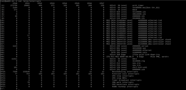

    To sure that GPIO affinity settings are applied, I used uio driver and read /proc/interrupts.
    [ GPIO # ] -> [ GPIO Module # that used in uio device node] -> [ uio # ]
    1. GPIO0_42 -> MAIN_GPIO0 (Affinity set to CPU#0) -> uio0
    2. GPIO0_36 -> MAIN_GPIO2 (Affinity set to CPU#3) -> uio1
    Result of cat /proc/interrupts :
    Device nodes used for test :
    uio0: uio0 {
    	compatible = "uio-gpio";
    	status = "okay";
    	interrupt-parent = <&main_gpio0>;
    	interrupts = <42 IRQ_TYPE_EDGE_RISING>;
    uio1: uio1 {
    	status = "okay";
    	interrupt-parent = <&main_gpio2>;
    	interrupts = <36 IRQ_TYPE_EDGE_RISING>;
