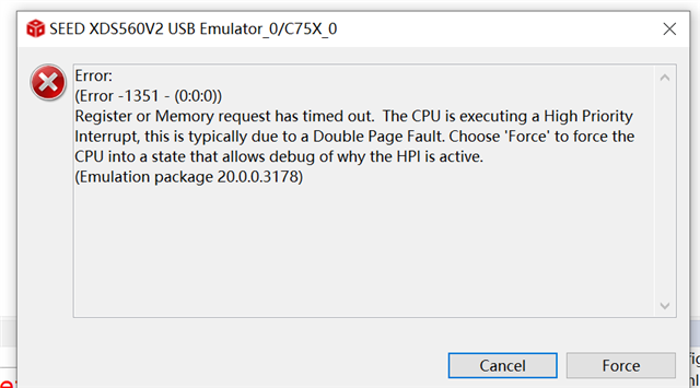

My SDK is mcu_plus_sdk_j722s_11_00_00_12.
If I only do DebugP_log("hello! \r\n"); like this in main(), it works well. I can reload the program and debug it.
But if I create a task,At first run in the debug session, everything went perfectly smooth without any error. However, once I stop debugging and rebuidling the code, I got an unexpected error regarding High Priority Interrupt
The previous email said educing the memory section to 63 bytes as suggested.I don't unstersatnd how to do it.
Either we shoud modify the linker.cmd or do something? Could you give me more details. Thanks
