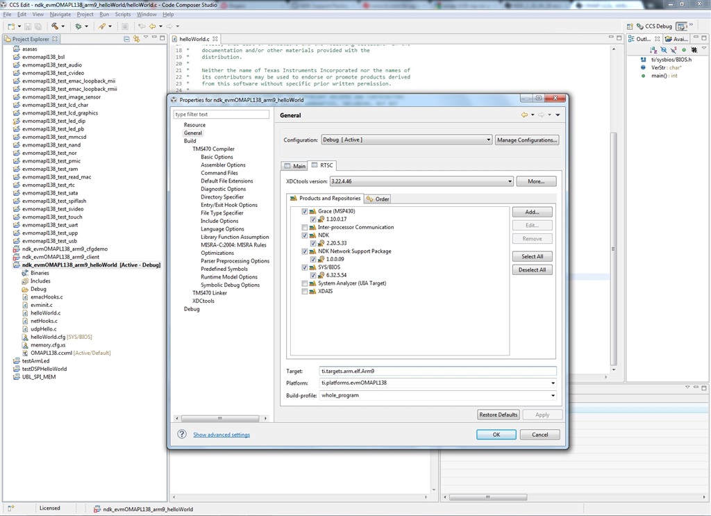

I'm using the following:
- CCSv5.1.0.09
- OMAP-L138 EVM (Logic PD) (OMAP SOM connected on the baseboard, no utility board)
- Lastest GEL files (given to me by Alan from the BIOS forum)
- XDS100v2
- NDK 2.20.05.33
- NSP 1.00.00.09
I imported the ARM projects into CCS. I had to change the NSP, NDK and BIOS versions of the projects to use the latest I installed. I also had to change the RTSC target. Now, my projects compile. There are 3 problems:

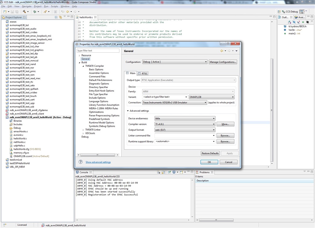

- I tried to run both the HelloWorld and the Client examples and the output looks like this:
[ARM9_0] Using default MAC address
[ARM9_0] Using MAC Address: 00-08-ee-03-14-99
[ARM9_0] MAC Address = 00-08-ee-03-14-99
[ARM9_0] EMAC should be up and running
[ARM9_0] EMAC has been started successfully
[ARM9_0] Registeration of the EMAC Successful
It never goes more far than this. There seems to be a problem, since I don't get any IP address or DHCP feedback at all and according to the doc, I should. I also checked on the server DHCP list and the board is not present in the leased addresses.

  • I found the problem. Actually, I found the answer:
    http://e2e.ti.com/support/development_tools/code_composer_studio/f/81/t/111915.aspx#396317
    My XDS100v2 was updated, my clock was adaptative, but my BOOT mode was not on the EMU Debug choice. All switches were OFF. This made the Task Example work fine. The printing in the console is still really slower when coming from the ARM (the DSP side is really quick, same clocks). But at least it doesn't hang. Hope this time it is the real reason! :)
