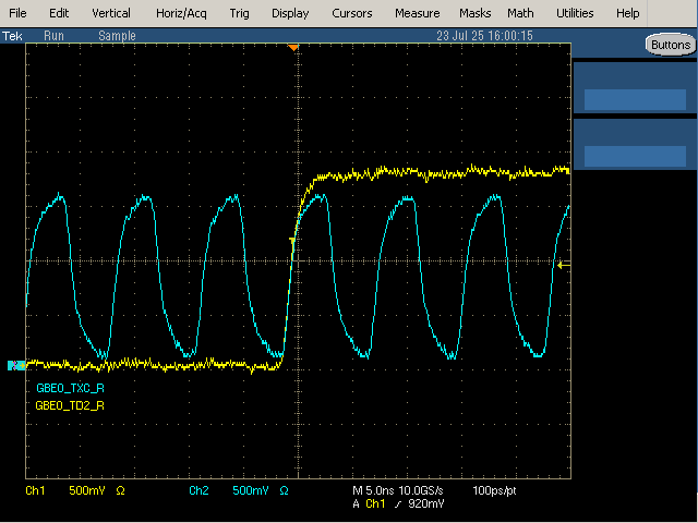

according to the datasheet, there should be an internal RGMII delay on the TX path towards the PHY. We cannot measure this delay though. Can you confirm, that there actually is a delay on the TX path?
I'm asking because the network transmit path stops working if I disable the delay in the PHY (which should not be needed because of the fixed delay of the SoC).
-michael

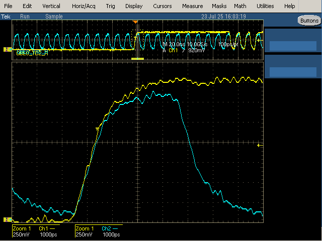

    Interesting, I agree that I don't see the TXC delayed w.r.t to the TDx.
    Have you configured the PHY with the RGMII-ID mode enabled?
    From the TRM register sheet, I see the RGMII internal delay control registers as below. On reset, the default value is 0, but please confirm if it is 0 or 1.

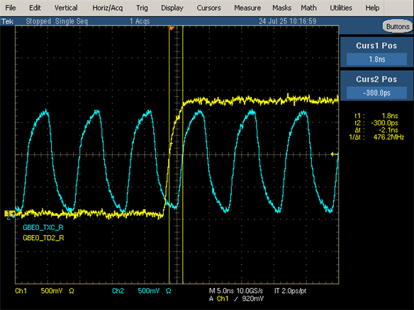

    after Reset/PowerOn RGMII-ID mode bit is '1' = no_delay (this is exactly that what I measured!).
    When I set RGMII-ID mode bit to '0' (= int_delay) then delay is enabled but interface is no more operational...see picture below....
  • Hi Joerg,
    Ok got it. Good to see that it matches your earlier measurement where the internal delay was non-existent.
    when enabling the rgmii_id mode, we can now see the delay as expected.
    about the link break when enabling the internal delay, have you also configured the PHY to provide the TX delay making them violate the setup/hold timings?

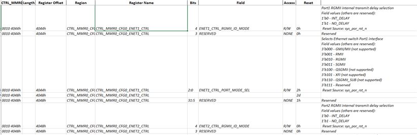

    As Shreays shared screenshot of CTRL_MMR_ENET_CTRL,  ID_MODE bit is R/W.
    What is the source document of that screenshot. I've just downloaded the latest AM67A TRM (https://www.ti.com/de/lit/zip/sprujb3) and there is not documented Bit 4.

    I have verified the excel document, it was  mentioned as reserved filed.
    Let me check internally and get back to you on Monday. It would be a documentation issue.

    As per above, you were able to change the bit field.  As it is common register across TDA4 devices for ENET CTRL we know bit fields very well.
    If you refer to other device's TRM, you can find the description.
