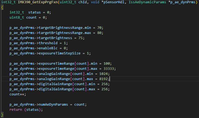

We have a problem about changing Exposure Time, we set AE mode on auto, and exposure_time_range to [100, 33333]

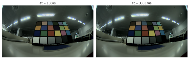

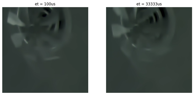

But by judging from the images we took in different exposure time(100us and 33333us) and the same Analog Gain(1024). They seem the same!
So can not Exposure Time be changed so simply? Like being forced to set as 11000? Or it acutually is changing, just we need some more accurate tools to test?
