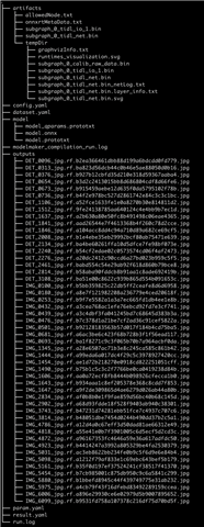

For the second approach I have used edgeai-modelmaker and modified the default config_detection.yaml to use my COCO format dataset. The compilation in this case gets completed with errors such as "Invalid Layer Name /multi_level_conv_cls.0/Conv_output_0". Attaching the compilation log for the same -
modelmaler_compilation_run.log
I have validated that I am able to get predictions from the model in the ONNX format and it's mAP is not zero. However I am facing the above issues while trying to compile the models for inference on the SK-AM62A-LP SOC. I have uploaded the logs I felt necessary for conveying this issue. Do let me know should you require any additional files for debugging. Please suggest the potential issues and solutions.

    Upon looking deeper I found that the compilation folder was indeed missing some files and not just the artifacts.yaml. The run.log in the compilation folder reveals the following -

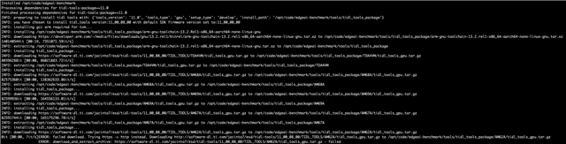

    While setting up the docker environment I am using for my development, the edgeai-benchmark fails to download tidl_tools for AM62A SoC specifically, while it works for other SoCs. The url used for the download in the setup scripts provided is -
    http://software-dl.ti.com/jacinto7/esd/tidl-tools/11_00_08_00/TIDL_TOOLS/AM62A/tidl_tools_gpu.tar.gz --> This URL seems to be not working.
    I would appreciate a prompt response as it seems like a quick fix to me. Any public URL which contains the tidl_tools_gpu.tar.gz for AM62A v11_00_08_00 would be perfect.
    Knowing your team is still developing and bugfixing on the edgeai-tensorlab repository, I would also suggest addition of some test cases to make sure all the provided URLs are functioning.
    Akash
  • Hello Akash,
    AM62A did not have an 11.0 SDK release. As a result, the automated code for pulling/applying the tidl_tools path download did not find tools for this specific SoC.
    Correct; it unfortunately does not exist.
    Instead, there would be an 11_00_07_00 release, which produces model-artifacts that are backwards compatible to the 10.1 SDK.
    The way to apply the changes for 11_00_07_00 into the 10.1 SDK are covered within edgeai-tidl-tools (update_target.md) [0]. You can download the tidl-tools for this version and place it in the same tools/AM62A/tidl_tools location, and try compiling from there. You will need to follow the documentation [0] for how to update the target before using the resulting artifacts.
    [0] https://github.com/TexasInstruments/edgeai-tidl-tools/blob/11_00_07_00/docs/update_target.md

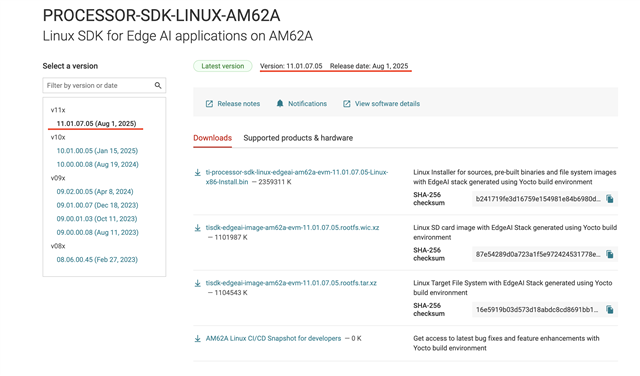

  • Hello Reese,
    I am seeing a SDK release for AM62A, which seems to be a 11.0 SDK release as shown in the screenshot below -
    Please do clarify what versions/branches of edgeai-tensorlab should I be using for the above latest AM62A SDK to train my models with.
  • Hi Akash,
    This is 11.01 SDK.  Our version strings follow convention of two characters per version component, so 11.1 and 11.01 mean the same. Period is the important delimiter.
    edgeai-tensorlab typically lags behind SDK release by several weeks. AM62A had an earlier release than other Edge AI / ADAS processors. The tensorlab update will not come out until all devices in the Edge AI category are ready. 11.1 TIDL tools are also not available for AM62A.
    My suggestion would be to train with r11.0 branch. However, you should first replace tools/AM62A/tidl_tools (which failed to setup before) with 11.00.07 tidl tools or 10.01.04 tools, and use these with the 10.1 SDK for now.
    BR,
