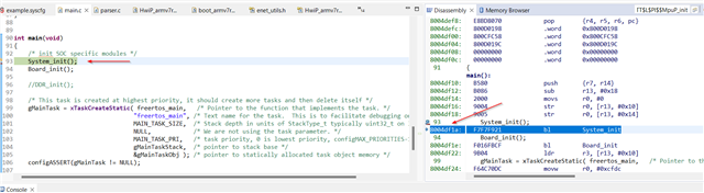

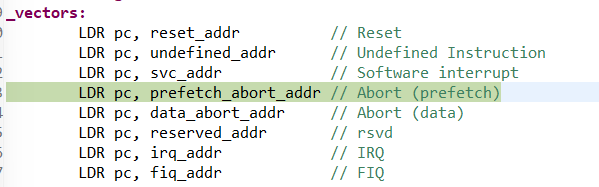

I'm currently experimenting with the AM6442 EVM board using CCS. I'm trying to get an example project (FreeRTOS based) from the MCU+ SDK v10.01, which I've enhanced, to run from DDR on the R5F0_1 Core as I've exceeded the MSRAM space. The project builds fine, but when I load it to the Core in the XDS110 Debug interface I get nothing. The program is in run state, breakpoints dont hit, when I suspend it is stuck in a prefetch_abort_addr call in HwiP_armv7r_vectors_freertos_asm:

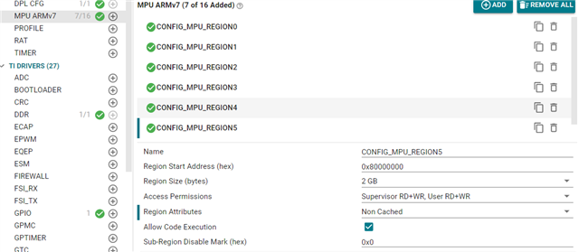

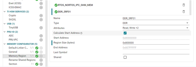

syscfg settings related to DDR:

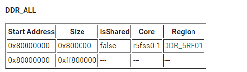

The Memory Summary shows:

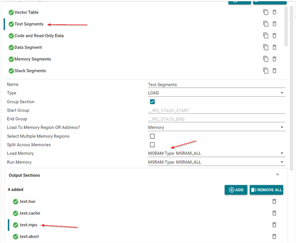

My modifications to the Memory Configurator->Section result in the following in my linker.cmd file:

    DDR_5RF01   : ORIGIN = 0x80000000 , LENGTH = 0x800000

    Thanks for the reply. I'm not calling it explicitly from my code, but I see that it is being called within the ti_drivers_config.c->System_Init() which is the first call in my main(), and it is using the gDdrParams struct that was generated by the online Ti tool and resides within the board_ddrReginit.h file.
    Answering your reply made me realize that yes, I do have a program loaded to the board which automatically boots in OSPI mode, I hadn't considered that this could possibly interfere with what I was loading to the r5f01 in CCS, so I reflashed the board with the default_sbl_null.cfg. Unfortunately didn't help.
    I have the EVM set to OSPI boot mode, I power on the board -> launch target configuration -> connect to r5f01 -> issue CPU reset -> load my .out file
    I notice that when I load the .out file, I see "MAIN_Cortex_R5_0_1: GEL Output: CPU reset (soft reset) has been issued through GEL." in the Console window in CCS.
    The r5f01 core goes into running state and I get no other feedback. When I hit suspend, it's at that prefetch_abort_addr line.
    also note, I put a breakpoint at the first call within my main() (which is the call to system_init()) and it never arrives there.
    While the Core is in running state, I see it's not just DDR memory which isn't initialized, it appears nothing is. MSRAM, R5F_VECS, R5F_TCMA, etc, everything is "????"
    Incase it matters, for this project I started from the "empty_am64x-evm_r5fss0-1_freertos_ti-arm-clang" project, and added the code from one of the gpio projects (toggle the TEST_LED1) as well as an IPC_spinlock shared memory example project.

    Next, while debugging, we discovered that all of the MPU functions (starting with MPU_init()) were loaded into DDR, which creates the problem because DDR needs to be fully setup with the MPU before we can access it.
    In examining all of my memory sections closely, I realize that the .text.mpu output section was pointing to DDR space, I modified this region to be loaded into MSRAM space and I could get my actual code to run out of DDR space
    Now when I breakpoint in main(), I can verify that my actual code is properly loaded in DDR space.
