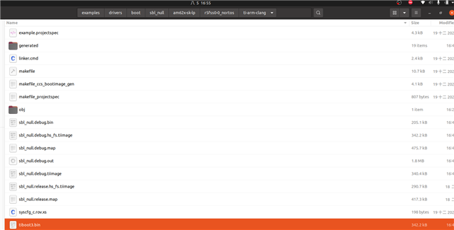

    this is belong driver layer, you should build driver / libary first before building tiboot3
    you need to replace "tiboot3.bin", project code (binary) as below. (MCU SDK, NULL_SBL)
    Related build steps,
    /work/am62_lp/mcu_plus_sdk_am62x_10_01_00_33$ make -s libs clean
    /work/am62_lp/mcu_plus_sdk_am62x_10_01_00_33$ make -s libs PROFILE=debug
    make -s examples PROFILE=debug
    make -s -C examples/drivers/boot/sbl_null/am62x-sk-lp/r5fss0-0_nortos/ti-arm-clang PROFILE=debug
    and then replace "tiboot3.bin" to SD boot partition

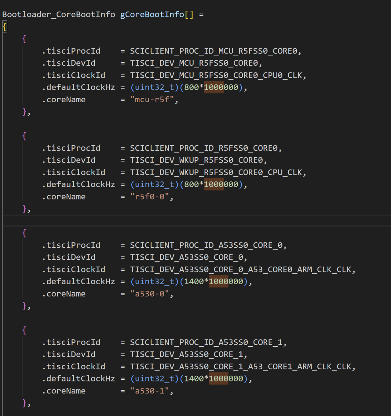

    1. Change the frequency in bootloader_soc.c (change the .defaultClockHz for a core in gCoreBootInfo)
    2. Rebuild the library
    3. Rebuild SBL
    this should be sufficient, I was able to change the frequency of A530-0 to 10GHz using this method:

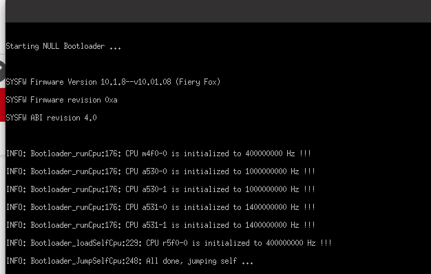

    Starting NULL Bootloader ...
    SYSFW Firmware Version 11.0.7--v11.00.07 (Fancy Rat)
    SYSFW Firmware revision 0xb
    SYSFW ABI revision 4.0
    INFO: Bootloader_runCpu:137: CPU m4f0-0 is initialized to 400000000 Hz !!!
    INFO: Bootloader_runCpu:137: CPU a530-0 is initialized to 1000000000 Hz !!!
    INFO: Bootloader_runCpu:137: CPU a530-1 is initialized to 1400000000 Hz !!!
    INFO: Bootloader_runCpu:137: CPU a531-0 is initialized to 1400000000 Hz !!!
    INFO: Bootloader_runCpu:137: CPU a531-1 is initialized to 1400000000 Hz !!!
    INFO: Bootloader_loadSelfCpu:127: CPU r5f0-0 is initialized to 400000000 Hz !!!
    INFO: Bootloader_JumpSelfCpu:157: All done, jumping self ...

    * Here is my code.
    source/drivers/bootloader/soc/am62x/bootloader_soc.c
    Change A530-0 to 1GHZ, and change M4 to 200KHZ
    ootloader_CoreBootInfo gCoreBootInfo[] =
            .tisciProcId    = SCICLIENT_PROC_ID_MCU_M4FSS0_CORE0,
            .tisciDevId     = TISCI_DEV_MCU_M4FSS0_CORE0,
            .tisciClockId   = TISCI_DEV_MCU_M4FSS0_CORE0_VBUS_CLK,
            .defaultClockHz = (uint32_t)(200*1000000),
            .coreName       = "m4f0-0",
            .tisciProcId    = SCICLIENT_PROC_ID_R5FSS0_CORE0,
            .tisciDevId     = TISCI_DEV_WKUP_R5FSS0_CORE0,
            .tisciClockId   = TISCI_DEV_WKUP_R5FSS0_CORE0_CPU_CLK,
            .defaultClockHz = (uint32_t)(400*1000000),
            .coreName       = "r5f0-0",
            .tisciProcId    = SCICLIENT_PROC_ID_A53SS0_CORE_0,
            .tisciDevId     = TISCI_DEV_A53SS0_CORE_0,
            .tisciClockId   = TISCI_DEV_A53SS0_CORE_0_A53_CORE0_ARM_CLK_CLK,
            .defaultClockHz = (uint32_t)(1000*1000000),
            .coreName       = "a530-0",
            .tisciProcId    = SCICLIENT_PROC_ID_A53SS0_CORE_1,
            .tisciDevId     = TISCI_DEV_A53SS0_CORE_1,
            .tisciClockId   = TISCI_DEV_A53SS0_CORE_1_A53_CORE1_ARM_CLK_CLK,
            .coreName       = "a530-1",
            .tisciProcId    = SCICLIENT_PROC_ID_A53SS0_CORE_2,
            .tisciDevId     = TISCI_DEV_A53SS0_CORE_2,
            .tisciClockId   = TISCI_DEV_A53SS0_CORE_2_A53_CORE2_ARM_CLK_CLK,
            .defaultClockHz = (uint32_t)(1400*1000000),
            .coreName       = "a531-0",
            .tisciProcId    = SCICLIENT_PROC_ID_A53SS0_CORE_3,
            .tisciDevId     = TISCI_DEV_A53SS0_CORE_3,
            .tisciClockId   = TISCI_DEV_A53SS0_CORE_3_A53_CORE3_ARM_CLK_CLK,
            .coreName       = "a531-1",
        .tisciProcId    = SCICLIENT_PROC_ID_HSM_M4FSS0_CORE0,
        .tisciDevId     = TISCI_DEV_HSM0,
        .tisciClockId   = TISCI_DEV_HSM0_DAP_CLK,
        .coreName       = "m4f1-0",
    * Re-build all binary
    /mcu_plus_sdk_am62x_10_01_00_33$ make -s -f makefile.am62x libs-clean
    /mcu_plus_sdk_am62x_10_01_00_33$ make -s -C examples/drivers/boot/sbl_null/am62x-sk-lp/r5fss0-0_nortos/ti-arm-clang clean
    /mcu_plus_sdk_am62x_10_01_00_33$ make -s -C examples/drivers/boot/sbl_null/am62x-sk-lp/r5fss0-0_nortos/ti-arm-clang all
    /mcu_plus_sdk_am62x_10_01_00_33$ make -s -C examples/drivers/ipc/ipc_rpmsg_echo_linux/am62x-sk-lp/r5fss0-0_freertos/ti-arm-clang clean
    /mcu_plus_sdk_am62x_10_01_00_33$ make -s -C examples/drivers/ipc/ipc_rpmsg_echo_linux/am62x-sk-lp/r5fss0-0_freertos/ti-arm-clang all
    * Flash to OSPI NAND (SBL_NULL+DM)
