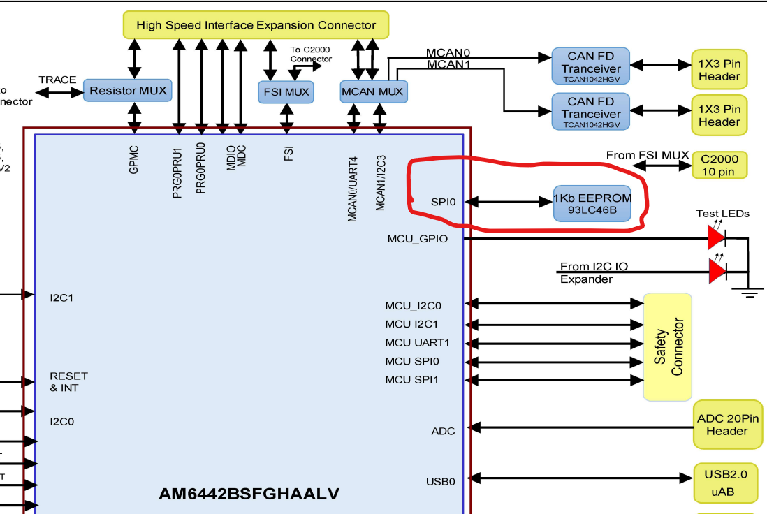

  • Hi Paula,
    Need access the EEPROM with SPI0 interface which is connected to near the processor and simply read/write needs to be done with the EEPROM.

  • Hi Paula,
    Thanks for your information.
    I am asking about SPI EEPROM not I2C EEPROM. Please find in below snapshot marked with RED color.
  • Sorry you are right Dinesh, please ignore U-Boot I2C read/write instructions.
