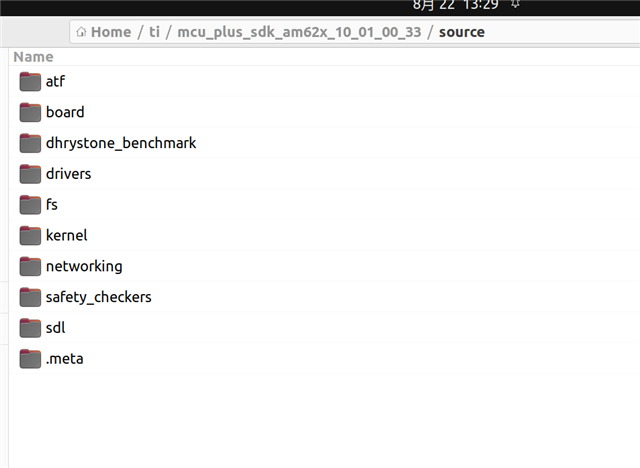

Hi Bert,
The DM firmware code is at <MCU+ SDK>/examples/drivers/ipc/ipc_rpmsg_echo_linux/am62x-sk/r5fss0-0_freertos/
Please refer to section "Disable the WKUP_UART access from DM firmware" in the link below to compile it.
