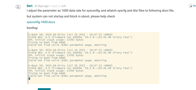

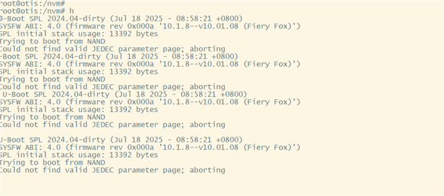

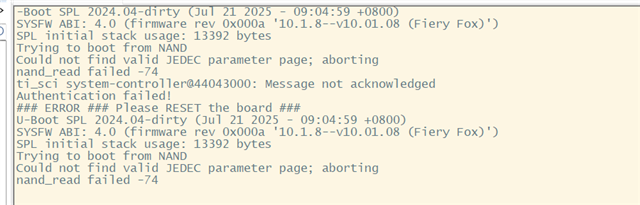

  • I adjust the parameter as 1600 data rate for sysconfig, and attatch syscfg and dtsi files to following docx file,
    but system can not startup and block in uboot, please help check
    sysconfig-1600.docx
    bootlog:
    it appears that the bootlog shows that you are successfully getting through DDR initialization now, but you are hanging trying to boot from your NAND device.  So now this is a completely different problem.
    How did you program the NAND device?  Can you give details on what device it is any how you configured it in the device tree?

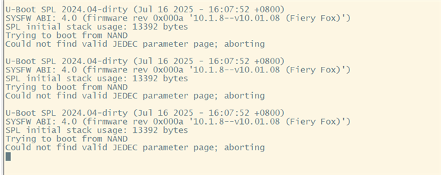

  • hi  James
      I have tried CWL 11 dtsi file,  ,  but still can't work, will block in uboot

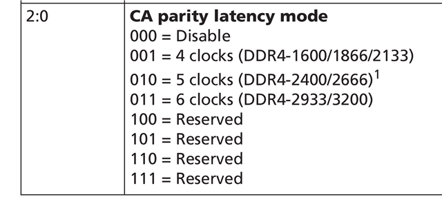

    DDRSS.ddr4.config_dram_mr0_cl = 13;
    DDRSS.ddr4.config_dram_mr2_cwl = 9;
    DDRSS.ddr4.config_dram_mr5_ca_par_lat = "4 clocks";
    If you could change these one by one, back to what you have for 2400 configuration, then i might be able to explain what is going on.
    James
  • hi  James
      As you predicted,  after restore cl/cwl/ca_par_lat value same to  2400 configuration  for 1600 configuration,  system can boot normally .
    please help explain the reason , is it maybe hardware layout issue ?
    DDRSS.ddr4.config_dram_mr0_cl = 17;
    DDRSS.ddr4.config_dram_mr2_cwl = 12;
    DDRSS.ddr4.config_dram_mr5_ca_par_lat = "5 clocks";

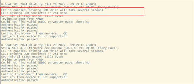

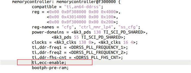

    I add the property ti,ecc-enable  in the dts file k3-am64-ddr.dtsi  to enable the ECC, system can not boot indeed, will block in uboot
  • discuss with team, our device may work in very harsh environment, so we may need enable CA Parity and CRC function,   you said "CA parity would require some software changes to handle the errors correctly", so could you provide the sample code for the software change when enable CA parity ?   for the write CRC function, please also help provide the method to enable it  .
    we use the linux SDK version 10.01.10.04
  • Bert, ECC is a function of the controller, so it will work with your memory.  I suspect you have something wrong in the ECC configuration.
    Software support for CA Parity and CRC is currently not scoped.  If you were to enable these, they would have to be handled with custom code.  Would ECC be enough for your environment if we can get that working?
    James

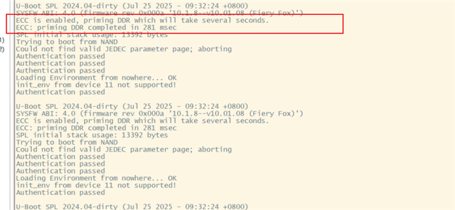

  • Maybe ecc is enough,  we will test .  so for ecc function,  I add the property ti,ecc-enable in the dts file k3-am64-ddr.dtsi to enable it,  Is it right?  any other configurations need to do?
  • I am sure add the property ti,ecc-enable in the ddr dtsi file and CONFIG_K3_INLINE_ECC in r5_defconfig file, but still boot failed,  block in uboot.  form the below boot log, you can see ECC is enabled.  we use DDR memory size id 512MB, is it the possible reason ?
  • Let me see if i can get help from the software team.
    Just to confirm, the boot works if you don't enable ECC?
    James
  • confirmed that system boot ok when disable ECC

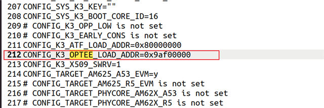

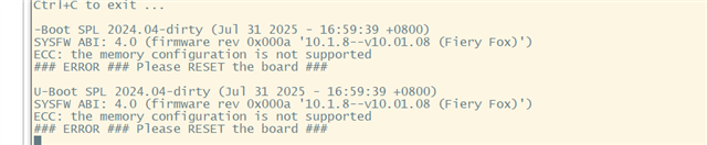

    Do you have SYS_MEM_TOP_HIDE option defined in your U-Boot a53 defconfig? If so, what is its value set to?
  • yes,below is the value
    CONFIG_SYS_MEM_TOP_HIDE=0x2600000
  • Hi Bert,
    When ECC is enabled, the total usable DDR size is 1/9 smaller, which is about 0x3900000. The total DDR size should be 0x1c700000. So there are at least three places in U-Boot which have to adjusted accordingly.
    First is the total memory size. In U-Boot devicetree arch/arm/dts/k3-am62x-sk-common.dtsi:
    memory@80000000 {
            reg = <0x00000000 0x80000000 0x00000000 0x80000000>;
    You probably already changed its size to 0x20000000. But please now change it 0x1c700000.
    The next is the OPTEE load address. It is defined in U-Boot devicetree arch/arm/dts/k3-am62x-sk-common.dtsi:
    secure_ddr: optee@9e800000 {
            reg = <0x00 0x9e800000 0x00 0x01800000>; /* for OP-TEE */
    Please change its location 0x9e800000 to 0x9af00000.
    Finally please add the new optee load address as following in your board a53 defconfig.
    CONFIG_K3_OPTEE_LOAD_ADDR=0x9af00000

  • Hi Bert,
    It turns out that the ATF and OPTEE packages have to be recompiled with the new OPTEE load address.
    Also currently the DM firmware is located outside of the DDR region once ECC is enabled. It has to be relocated too. I will let you know the details of the change once I figured it out.
    BTY,
    memory@80000000 {
    This total memory size change has to be done in arch/arm/dts/k3-am625-sk.dts. It overwrites the memory@8000000 node defined in k3-am62x-sk-common.dtsi.

    I just noticed that you are setting the CA parity to "5 clocks".  You should be setting it to "4 clocks", since you are running 1600MTs
    Can you try with this setting?
    REgards,
    James
  • hi James
    I have already tried following value before,  it can't boot , block in uboot
