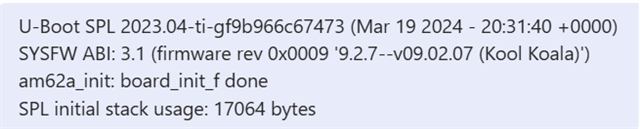

I am working on am62a7-q1 custom board. I have tried to boot with SD card and UART.
When try to boot rom SD card: -
My board is stuck after below logs: -

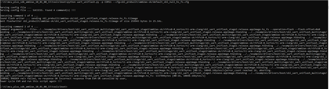

Then i have tried to boot from the UART and flash the binary.
1. sbl_uart_uniflash_stage1.release.hs_fs.tiimage stage1 flashed completely
2. sbl_uart_uniflash_stage2.release.appimage.hs_fs not able to flash
below logs i am getting while flashing: -

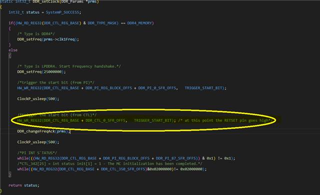

I tried to debug the code and found that the DDR is not initialized proper.
I found that DDR0_RESET0_N (SOC ball - P6) goes high at particular point.
in the below image highlighted the line where DDR0_RESET0_N is goes high.
