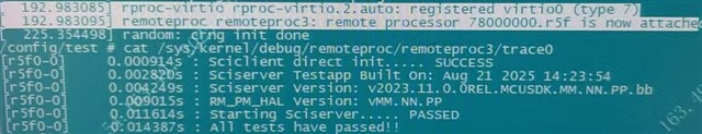

AM623: Mbox timeout in resp at continuous operating 4295312 seconds
Part Number: AM623
Other Parts Discussed in Thread: SK-AM62B
SDK9.2.1.09(Kernel V6.1.80)
sysfw:10.0.8 (update according to user guide)
When System continuous operates >49days reports: ti-sci 44043000.system-controller: Mbox timedout in resp(caller: ti_sci_cmd_get_device_exclusive+0x18/0x2c)
There are 4 set machines under testing >49days, all have this error at the same seconds in log. after this error, Linux system is still running, display normal, but I2C, SPI report error and component attached on it don't work.
Detail log SDK9.2  and SYSFW10.0 as below:
