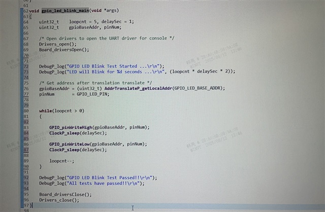

1. Symptom

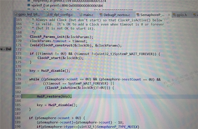

  • Scenario:

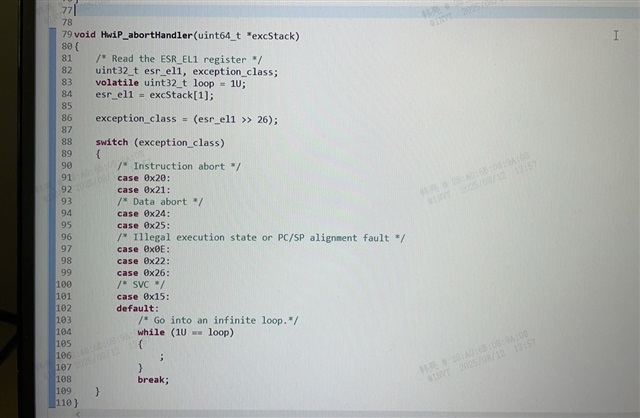

Warm boot causes DebugP_log() to hang. A53 stucks in the while loop in SemaphoreP_pend().
If DebugP_log() is commented out, it causes ClockP_sleep() to hang. A53 stucks in the while loop in HwiP_abortHandler().
ESR_EL1=0x02000000, ELR_EL1 =0x80001180
If cold boot, or both DebugP_log() and ClockP_sleep() are commented, system runs normally.
  • Affected Cores:
    Cortex-A53 only. R5F cores operate normally during identical warm boot sequences.
  • Repro Steps:
    1. Cold boot → System runs normally.
    2. Trigger warm boot (watchdog reset/IPC command).
    3. A53 fails at first HVC call post-reset
