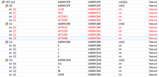

    int ADC_buf[4][4];
    Ptr* rmt=NULL;
    for (int i=0; i<4;i++)
    status_issue=SIO_issue(shandl, (Ptr)&ADC_buf[i][0], 4*sizeof(int), NULL);
    However function SIO_reclaim is never returned.
    SIO_reclaim(shandl, rmt, NULL);
    In a debug mode I see that values of first two buffers are permanently updated.
    However queue contents fromdevice do not change. I ask experts of Texas Instruments to pay attention to my problem. Thanks.

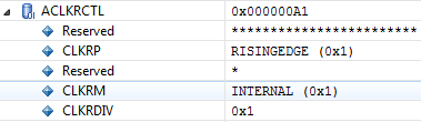

  • Hello. Weather excellent. The Siberian siesta ended. I edited tcf a file. As a result the situation, unfortunately, did not change.
    At calculation of frequency of clocking I address to this picture. (I notify, I made less frequency ACLKR, than in the project published by me.)
    Now at me the following situation with clocking. AUXCLK=24 MHz.. Coefficient HCLKRDIV=1. Coefficient CLKRDIV=6.
    If to follow a manual should be such situation : AHCLKR=24 MHz, ACLKR= 4MHz ,  AFSR=ACLKR/64=62.5 kHz.
    But I watch the following: AHCLKR=ACLKR= 24MHz ,  AFSR=ACLKR/64=375 kHz.
    The system does not react to change of coefficient CLKRDIV in any way.
    The system reacts only to change of coefficient HCLKRDIV. For example, at HCLKRDIV=6: AHCLKR=ACLKR= 4MHz ,  AFSR=ACLKR/64=62.5 kHz.

    1. "PFUNC" register values. As per the shared code, function mcaspUserInit() make all the pins (except the reserved bit) to 1, i.e to act as a gpio pin. Instead it should have been configured to act as a mcasp pin (refer the PFUNC register description in the mcasp manual)
    2. The bit fields "RCLKRST",  "RHCLKRST", "RSRCLR, "RSMRST" and "RFRST" in the "GBLCTL" register should be made one, this will make all of then to be active. But as per the snap shot in the previous conversation, it looks like the bit "RCLKRST" is '0', which explains why the CLKRDIV is not getting reflected. Step through the function Mcasp_localConfigRcvSection() in the mcasp. file to find out why it is not being set.

  • With register PFUNC everything is all right. Possibly configuration of clothespins is produced by the driver code. Here contents of this register:
    I analyzed the code of function Mcasp_localConfigRcvSection (). I found an error admitted by the developer of the driver.
    At first it was necessary to initialize register ACLKRCTL. Only then check up a state of bit CLKRM. I changed places of these two units of the code. As a result signals of clocking of a steel adequate the correct.  However, unfortunately, it did not solve a shared problem.
    At present AUXCLK=24 MHz, AHCLKR=24 MHz, ACLKR=4 MHz, AFSR = 62.5 kHz.
  • korobchenko andrej,
    The reset value for CLKRM is aways '1' and which indicates as internal clock generation. So, the code will work unless we modify the ACLKRCTL register somewhere else in the driver.
    Anyway, now you are getting the clock as per the configuration.

  • Call SIO_issue is completed successfully (status_issue it is always equal 0). I use loopjob buffer. Its size is equal 16000 byte. It is multiple to value   2 (number of slots) X 2 (number serializs) X 4 (word length).  To avoid a situation snap shot of the EDMA PaRAM I reduced frequency AFSR (62.5 kHz) and increased the size of the buffers, participating in an exchange (16000 byte).

    In the channel are transferred buffers ADC_buf [4].  The address of buffer ADC_buf [0] - C0030000 (he can be seen in register DST Parametr_Set32), ADC_buf [1] - C0033E80 (he can be seen in register DST Parametr_Set33), ADC_buf [2] - C0037D00, ADC_buf [3] - C003BB80. Program performance is locked on the first SIO_reclaim. Thus contents of buffers ADC_buf [0] and ADC_buf [1] regularly change. Alternately PaRAM_0 linking with PaRAM_32 and PaRAM_33. Thus contents of registers ParamSet_32 and ParamSet_33 (including registers SRC) NEVER CHANGE.
