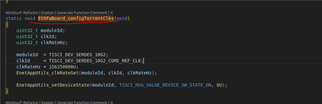

    Can you please confirm, have you configured SerDes1 clock with 100MHz clock?
    By default TI SDK using SerDes2 as per EVM connectivity.
    Can you please share the ETHFW log to check if any errors reported?
    Also, make sure SerDes1 not being used by Linux for any purpose?
    Check SGMII mode & Auto negotiation capabilities at PHY.
    By default SGMII with FORCED Link configured MAC in Master Mode and disables Auto-negotiation.

    3.
    The Linux device tree being used is the pre-built device tree from the TI EVM.
    Can you please check SERDES LANE CTRL registers from CTRL MMR register set, to check whether serdes lanes configured for CPSW ports or Other functionality.
    Sudheer

    static void EthFwBoard_configTorrentClks(void)
        uint32_t moduleId;
        uint32_t clkId;
        uint32_t clkRateHz;
        moduleId  = TISCI_DEV_SERDES_10G2;
        clkId     = TISCI_DEV_SERDES_10G2_CORE_REF_CLK;
        clkRateHz = 100000000U;
        EnetAppUtils_clkRateSet(moduleId, clkId, clkRateHz);
        EnetAppUtils_setDeviceState(moduleId, TISCI_MSG_VALUE_DEVICE_SW_STATE_ON, 0U);

  • HI.
    After changing to 156.25 MHz, an error occurred.
    clkRateHz = 156250000U;//100000000U;
    [MCU2_0] 13.268010 s: EthFwBoard_configTorrentClks
    [MCU2_0] 13.269002 s: PMLIBClkRateSet failed for clock Id = 6
    [MCU2_0] 13.269045 s: Assertion @ Line: 188 in enet_apputils_k3.c: BFALSE : failed !!!

       We will need sedser1 lane0 and lane2 to connect to PCIe devices running on A72 Linux.
       How can we route sedser1 lane1 SGMII at 2.5 Gbps to the switch?
    Sudheer
    [MCU2_0] 13.002277 s: EthFwBoard_configTorrentClks 2.5Gbps test.
    [MCU2_0] 13.002324 s: TISCI_DEV_SERDES_10G1 405 clkId 6 clkRateHz 156250000
    How are you getting above print, without setting SerDes1 clock from ETHFW?
    If you need PCIe + 2.5G SGMII and PCIe using Linux and SGMII from RTOS, then the boot loader has to configure the SerDes.
    U-boot SerDes doesn't support 2.5G XAUI configuration.
    The above combination is not possible from the TI SDK.
    Sudheer
    1.   How are you getting above print, without setting SerDes1 clock from ETHFW?
    From the log I provided.
    Does this mean that u-boot has already configured SerDes1?
    2.
