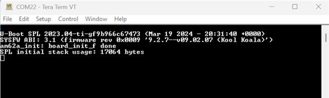

We have custom beard referenced from the EVK. i am trying to boot from the SD card
after below attached log board stuck

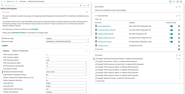

our DDR is different from the EVK. In EVK DDR is dual rank and in our custom board we have single rank.
we followed the below thread to change the DDR configuration. but still we are not able to boot from the SD card.
 AM62A7: RAM size configuration in the u-boot dts file
In our case DDR size is same as used in EVK (4GB). The only difference is we have DDR single rank.
I have made below changes in EVK u-boot source for changed ddr from dual rank to single rank.
