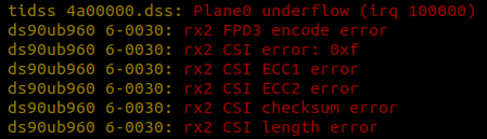

Issue in detail:
I could stream one camera properly for more than 12 hours, But when I check the stream for 3 cameras, My stream get freeze after 4 to 5 hours, only after ds90ub960 6-0030: rx2 FPD3 encode error, rx2 CSI error: 0xf, rx2 CSI ECC1 error and rx2 CSI ECC2 error . I do get rx2 CSI checksum error and rx0 CSI length error for nearly 3 times, but my stream did not get stuck, only after receiving FPD3 encode error my stream get stuck.
Below is my gstreamer command,
gst-launch-1.0 v4l2src device=/dev/video2 ! video/x-raw,width=1920, height=1080 ! tiovxldc out-block-width=128 ! "video/x-raw,format=NV12" ! queue !  mosaic.sink_0 v4l2src device=/dev/video3 ! video/x-raw,width=1920, height=1080 ! tiovxldc out-block-width=128 ! "video/x-raw,format=NV12" ! queue ! mosaic.sink_1 v4l2src device=/dev/video4 ! video/x-raw,width=1920, height=1080 ! tiovxldc out-block-width=128 ! "video/x-raw,format=NV12" ! queue ! mosaic.sink_2  tiovxmosaic name=mosaic sink_0::startx="<0>" sink_0::starty="<0>"  sink_1::startx="<1920>" sink_1::starty="<0>" sink_2::startx="<0>" sink_2::starty="<1080>"  ! kmssink sync=false driver-name=tidss -e -v
I could able to close the gstreamer pipeline after stream stuck and I could restart the gstreamer once again without any issue and I could get stream properly.
Below is my dmesg

I hope stream freeze is happened only because of  ds90ub960 6-0030: rx2 FPD3 encode error.  If Yes, how can i avoid this stream freeze. thanks in advance.
Along with this I do get one more error frequently tidss 4a00000.dss: Plane0 underflow (irq 100000). But till now there is no issue with this error. Please give a hint to mitigate this error too
Thanks in advance
  • Hi Jeyaprakash,
    The dss error is due to the DSS missing frames. This could be due to the pipeline stalling or buffering. This shouldn't cause any serious issues. If the fps was decreased, the issue would likely disappear as well.
    The deserializer issues, I have not seen before.
    If there are no more dss underflows after the encode error, I assume that is what's causing the freeze.
