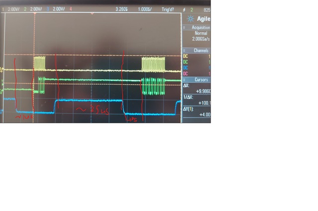

DRA821U: DRA821 MCSPI1 transaction to transaction delay time is too long
Part Number: DRA821U
Other Parts Discussed in Thread: DRA821
One of the carrier team (NUC) is having problem with SPI overload timing between transactions on Hydra board (DRA821 processor – to FRAM on carrier board).
It is taking SPI roughly 3.5us between each transaction (see below). This is very long and needs to be reduced.
Can TI team please check if this limitation is on the DRA821 side?
